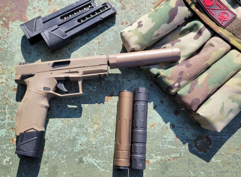

In the spirit of the thread I compared some 22 cans this week. Mars I appreciate the videos!
I’ve been .22 can shopping, and cans have now outrun hosts, I'm working to fix that (Ruger MkIV on order). The Otter Creek Titanium is mounted on the Taurus TX22, a SilencerCo Switchback and the bronze one is Dead Air RxDTi (collaboration with Ruger).
-OCL – 3.8 oz. – The lightest can. I bought an FRT for the TX22 which I haven’t run yet. Supposedly the TX22 runs best in FRT mode with a lighter can. Due to it’s simplicity, I think this might be my favorite.
-DA -5.6 oz. – This one has a 3D mono printed core but you can take the core out to clean it. Dead Air decided to make a muzzle device for this which I do not care for. The theory being you could buy multiple MDs and put them on all your 22s. Screw that idea, I will torque it into the can (or maybe locktite it in there) and leave it that way, and run it as a direct thread till I take it apart to clean it.
-SiCo – 6.9 oz. You can take sections off of this one and run it in a shorter and lighter configuration which I care nothing about, I will always run it full size. I’d rather it be simpler and all one tube, but I caught it on a big sale last summer and went for it.
How do they sound? I almost hate to say this, but I couldn’t tell much of a difference. If I had a 2nd host and could compare them side by side I might have more to say. As tested on one host, after taking one minute to switch cans, by the time I stepped back to the line they all sound pretty much the same to me. They all are hearing safe to my ears and I enjoyed them all. How is this comparison helpful to someone? Maybe it’s not but 22 cans are fun, the ammo is cheap and I’m glad I have them!
That’s what I did with mine, just torqued it in like the manual recommends and run as direct thread. I didn’t buy into the buy a bunch of muzzle devices thing that Ruger wanted you to do. And then if you want to run another .22 can, you have to take that special muzzle device off. No thanks.
