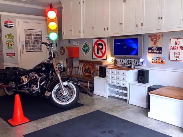

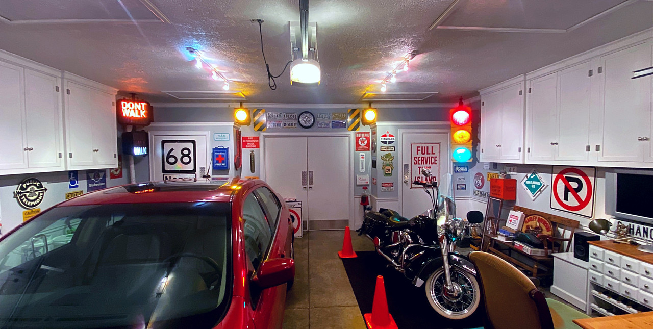

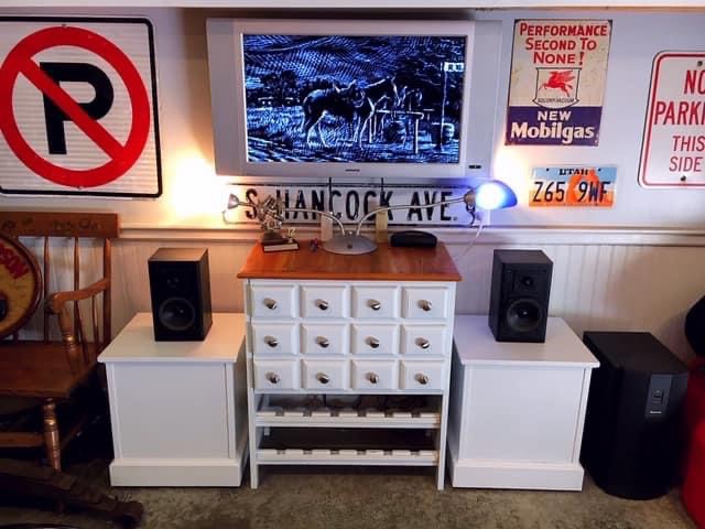

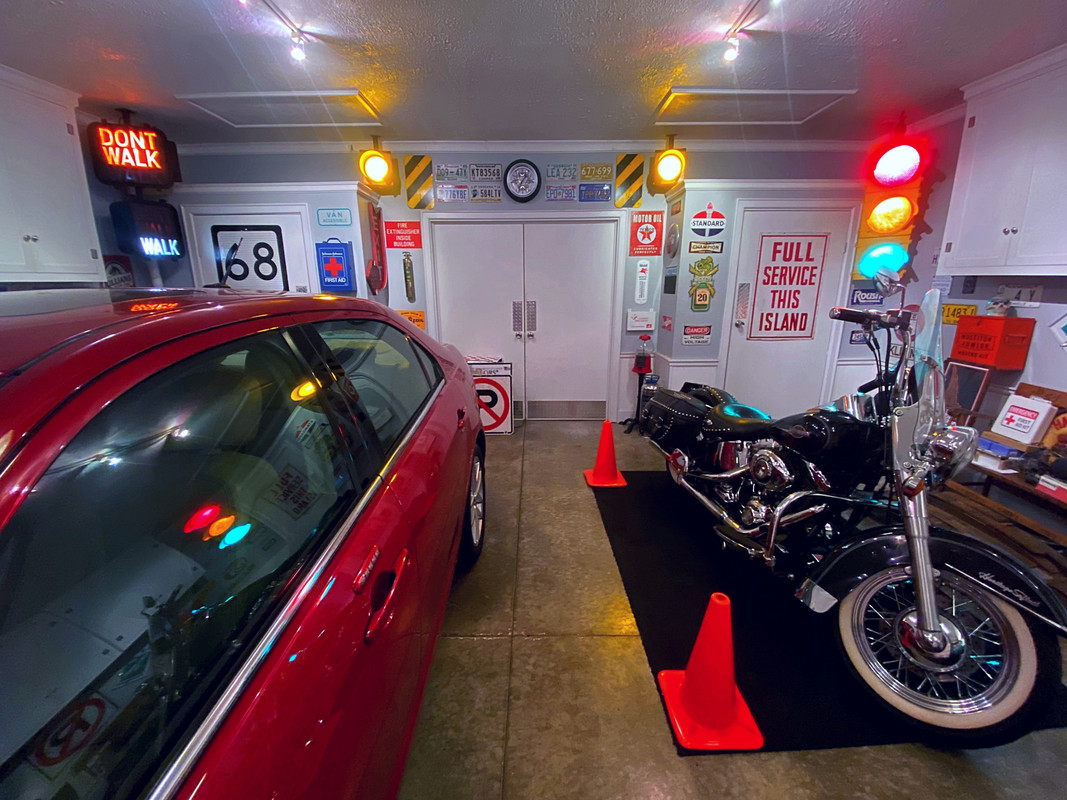

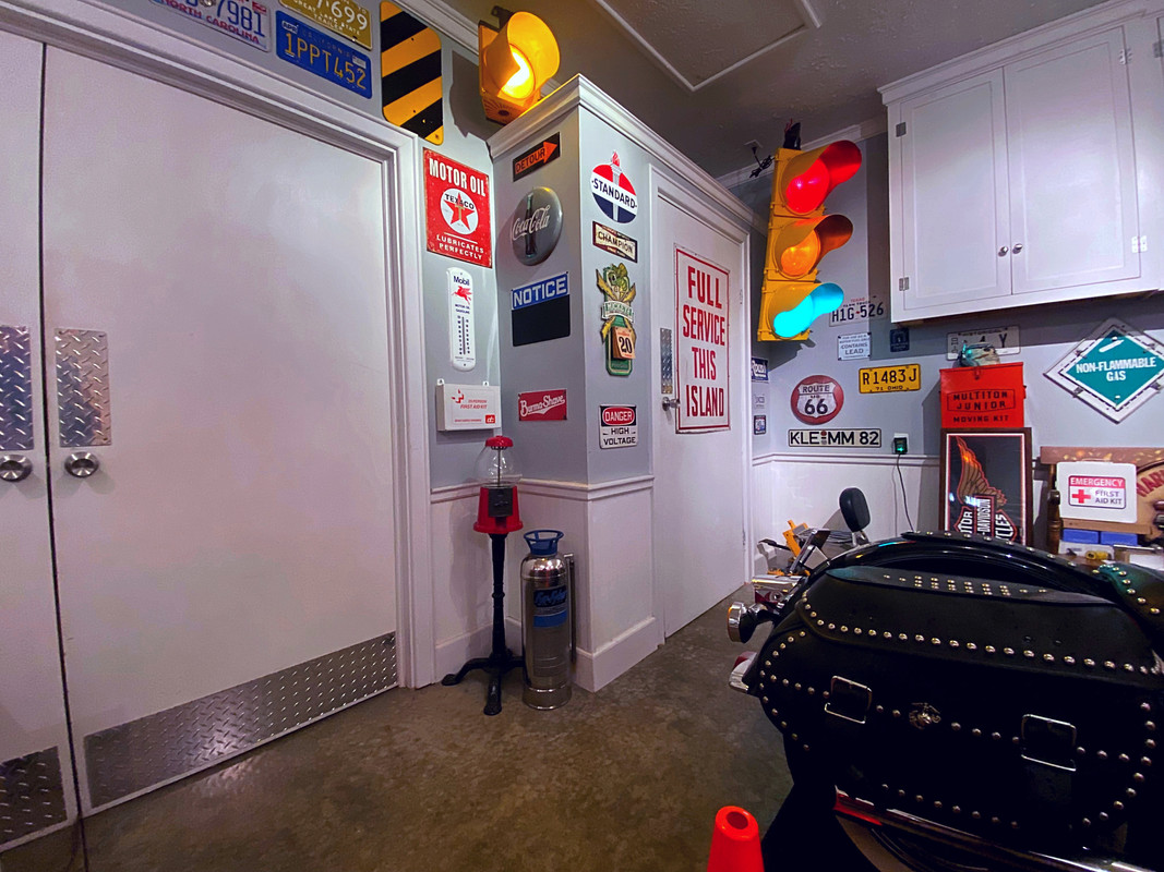

Take down the doors & rails.
Do it right, do it once & never have to concern yourself with it again.
Love having it fully insulated as I can work comfortably in winter in shirt sleeves.
The cabinets are filled with food stuffs and jars my wife canned.
Never lost anything to freeze. Have a remote temperature sensor out there to keep an eye on the temps.
Oh…& stomp the ceiling before you put up the crown molding. Wink
I know I know a garage is just a garage.
But it doesn’t have to be “just” a garage! LoL
