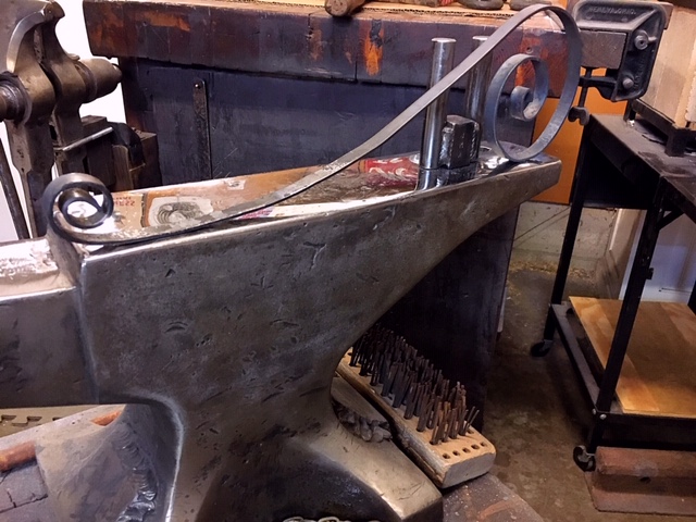

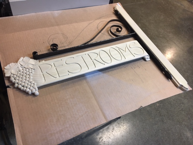

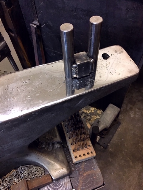

The sign mount is my first .
Needed a hardy tool for this.
I’ve tried other ways & never could pull it off.

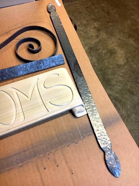

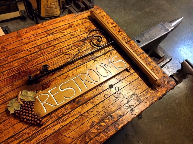

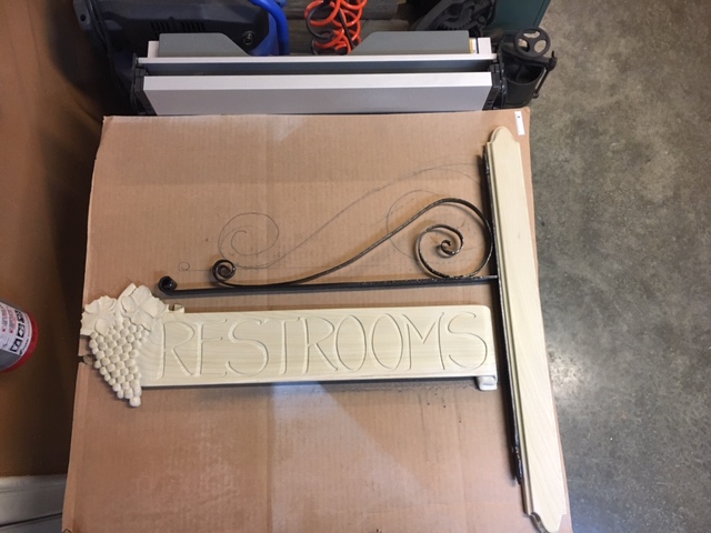

Put a hammered texture to the mounting bracket

Beautiful work!

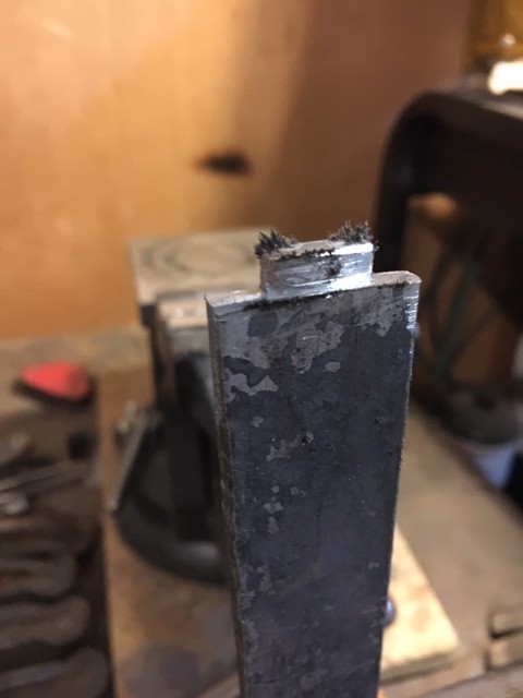

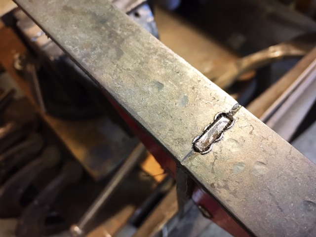

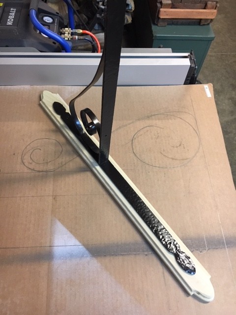

Tenon & mortis cut in

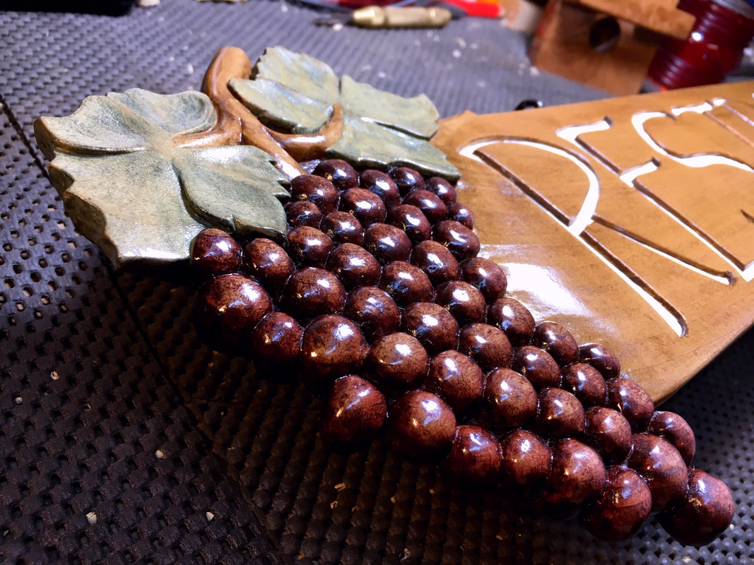

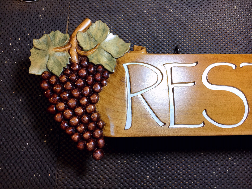

Went with an antiqued bronze paint on the bracket.
Looks like it’ll work for my first attempt.
On to the dyes & stains.
The only butts are in the aging room? Wink
Weld joint from the rear? That's kick-ass engineering for an eight-pound sign. <thumbs-up>

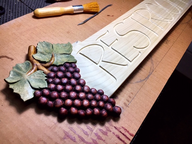

Woodman, I always prefer to see an older item show its wear vs. being stripped & restored to new condition. But getting the wear to look correct in a repair is an art unto itself.
Maybe it’s weird but I’m always both excited & a little sad to start staining a carving project.
I like the bare wood look but , at least most times, it does look better stained.
With multiple colors I always start with the darker tones before the lighter ones and the only paint I use is to fill the lettering.
The folks at Keim Lumber in Charm, Ohio are great when I’ve had stain & dye questions.
Mixing custom colors isn’t as easy as I’d hoped but nothing usually is. Frown

I see what you mean about bare wood. The leaves above the grapes had a great look, bare wood, especially. The poplar looked like birch.

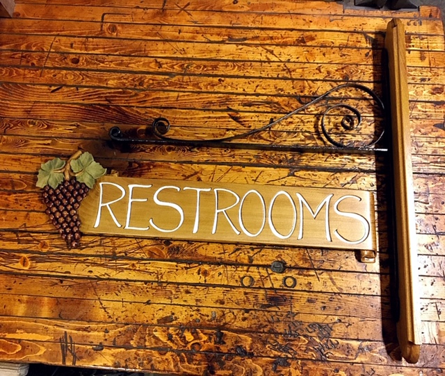

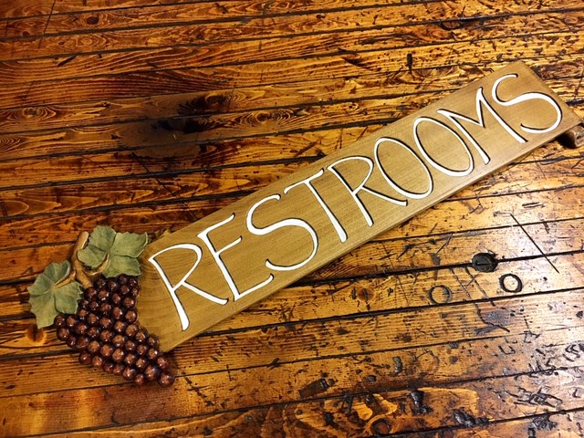

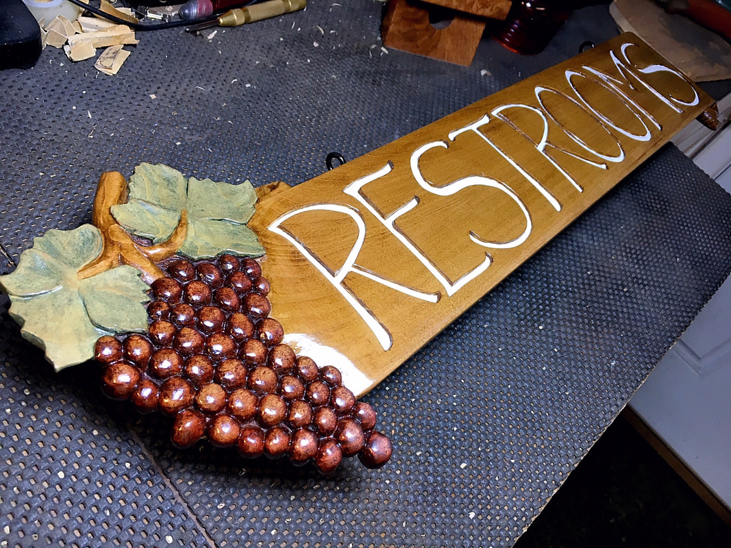

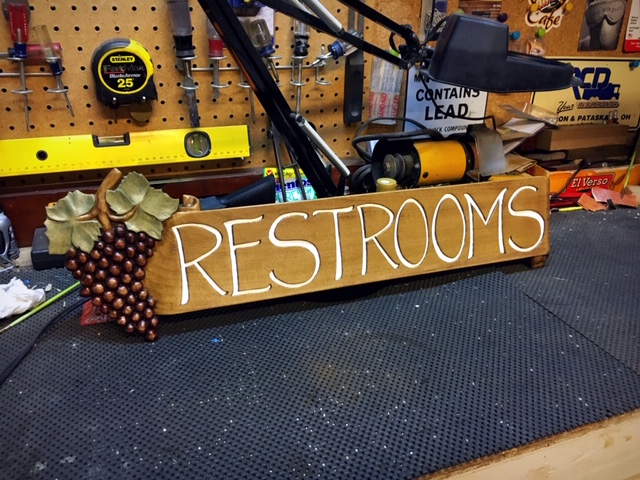

Staining & lettering is done.
Just have to figure out the chain lengths & hooks.

Lovely finish. Do you 0000 between coats? I'd like to find a supplier of 0000 brass or copper wool.
On the way to a rural bluegrass circle, along a farm road, one horse farm sports a fancy gate with wrought leaves woven into the rungs. Maybe I'll get pics tomorrow.
I hate listening to ideas from the peanut gallery. But ... Instead of chain, maybe hammered rods? With floral accent, naturally. Although hammering out leaves sounds like a whole new activity ...
My hypocrisy goes only so far
Picture of GrumpyBiker
I do use 0000 on the contours and usually wet sand with 2000g on the flats.
I like how the lacquer brings out the true colors of the piece.
