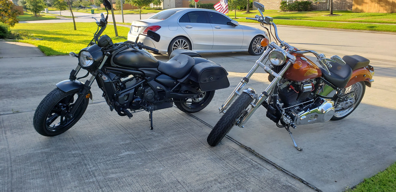

We pulled the rear wheel today & took off the gouged sprocket.
Of the sprocket bolts we could get an allen to fit (3/5), they all removed easily.
1/5 had the allen slot gouged, but there was just enough to get a pair of challen locks onto & remove.
None of these bolts had any loctite on them. Eek
Father-in-law is taking the wheel to a couple shops today to see about having the broken stud extracted. Local Harley dealer didn't want to touch it (over the phone) since it's not a Harley. Indian dealer wouldn't, since it's not a Polaris Indian.
Probably could've told the Harley dealer it was a Softail wheel & gotten a bite.
New swingarm & chain guard are in the garage, new chrome is mighty pretty.
Looks like we just need to disconnect the rear shocks & brake caliper, then pull the pivot bolts to drop the old swingarm.
Question now, is if we're going to have enough clearance on the right side. The R pivot bolt looks like it'll hit the rear cylinder exhaust. Cross that road when we get there.
Posts: 16889 | Location: Spring, TX | Registered: July 11, 2011Reply With QuoteReport This Post
Update:
Spent Friday afternoon & Saturday morning pulling the bent swingarm & prepping and installing the new one.
The guy my f-i-l used in CA said it was about a 4 hour job. All in, I'd say we spent between 6-8 hours.
Worst part, was getting the threaded sleeve mounted between the swingarm pivot bushings. Extremely tight fit, and once we got that installed, we realized that the chain has to split it, so we had to remove it to get the chain in the proper placement.
Looking at my prior post, the R pivot bolt did hit the rear exhaust muffler. Luckily, we were able to remove a frame bolt & tilt the exhaust, rather than removing it from the head.
Got out for an hour shakedown ride to make sure everything was riding properly & to get some mileage on the new rear tire.
All went well in the end, apart from the new rear tire being a little underinflated & my f-i-l running out of gas about a mile from the house (makes me love having a gas gauge on the Vulcan).
We'll give it a 2nd check-through on all the bolts before getting it back on the road again.

Luckily, I've had the Vulcan on the left for a few weeks now & have been getting some mileage in on it.
