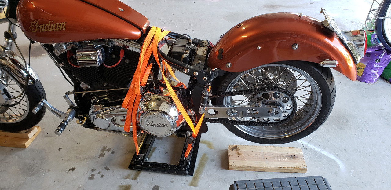

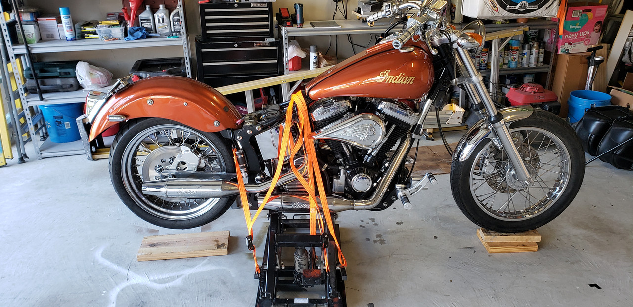

Getting started on teardown while looking for a new swingarm.
Got the seat, bags & brackets off. Looking at the course of attack once we're ready to start disassembly.
Looks like we just need to pull the wheel, remove the rear caliper from the arm, disconnect the rear shocks & pull the swingarm assembly. Then reverse when a new swingarm arrives.

New [used] swingarm ordered. Should be here Tuesday.
Probably start teardown this weekend.

I do have the svc manual. Will have to look through it again for tqe values. It's a pretty basic manual, though & covers the Scout/Spirit & Chief for 99-01.
F-I-L is debating on having the new arm chromed before we install, that'll add a bit of time to the project.
Personally, I'm ok with the black.
