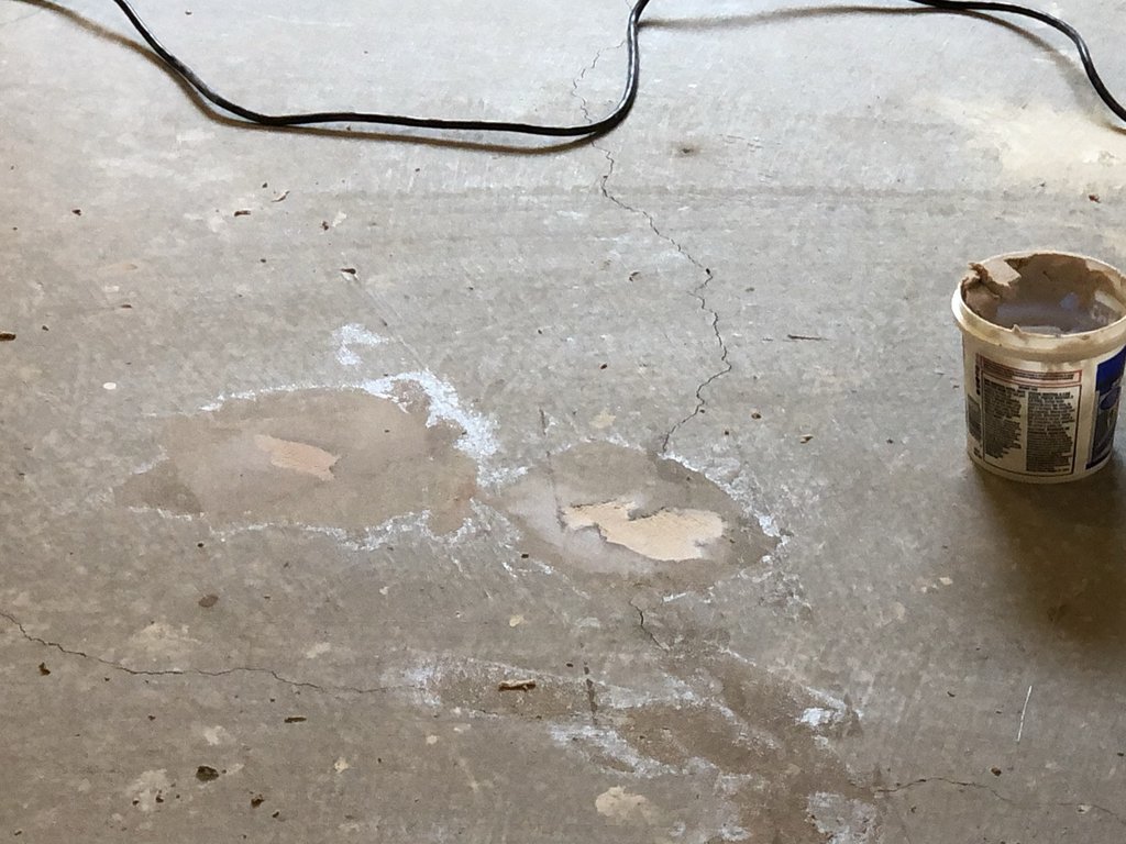

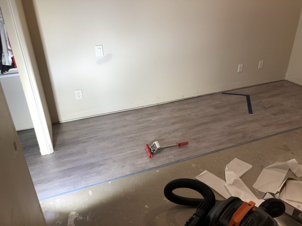

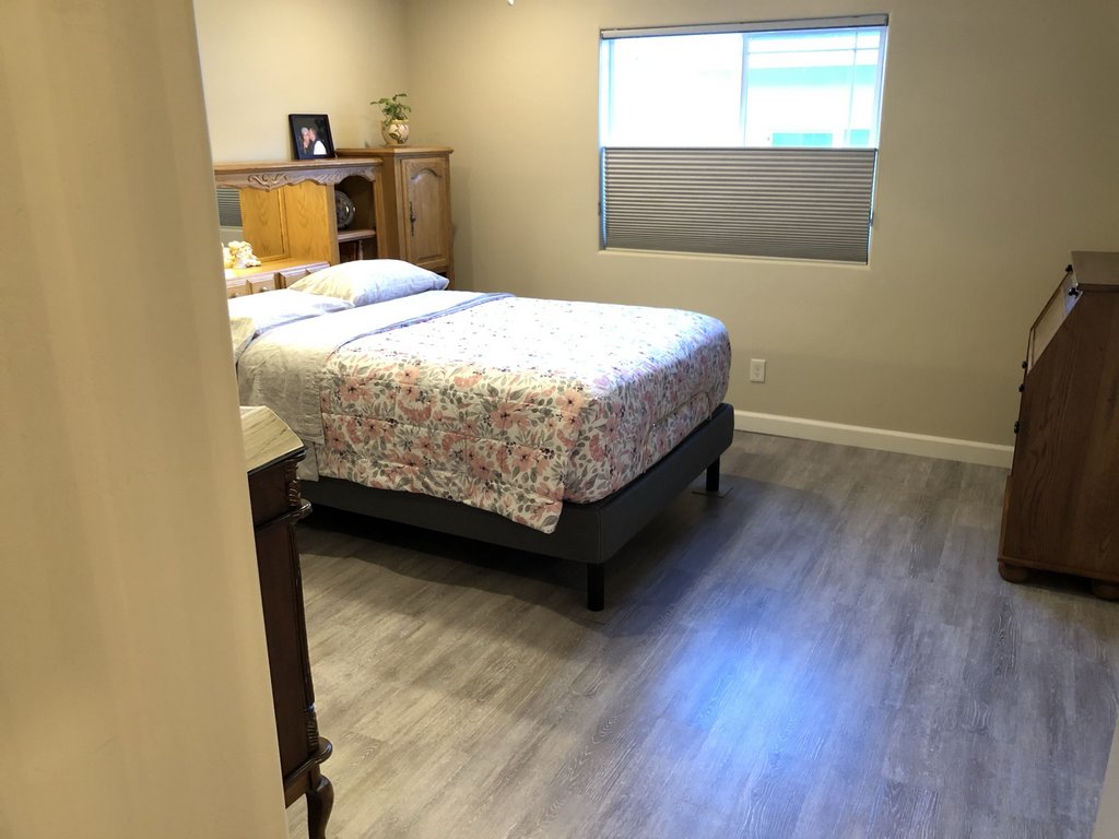

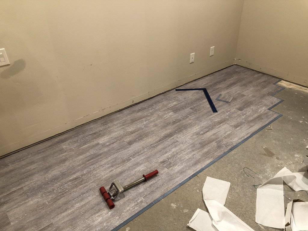

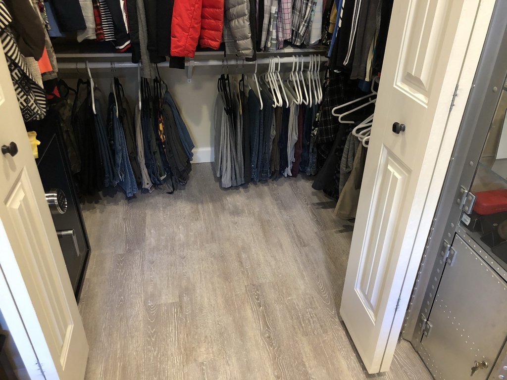

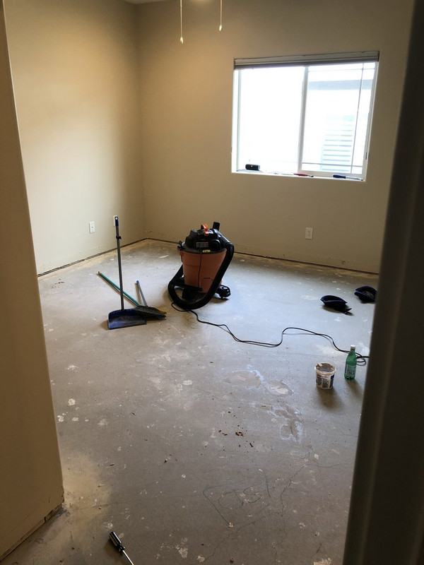

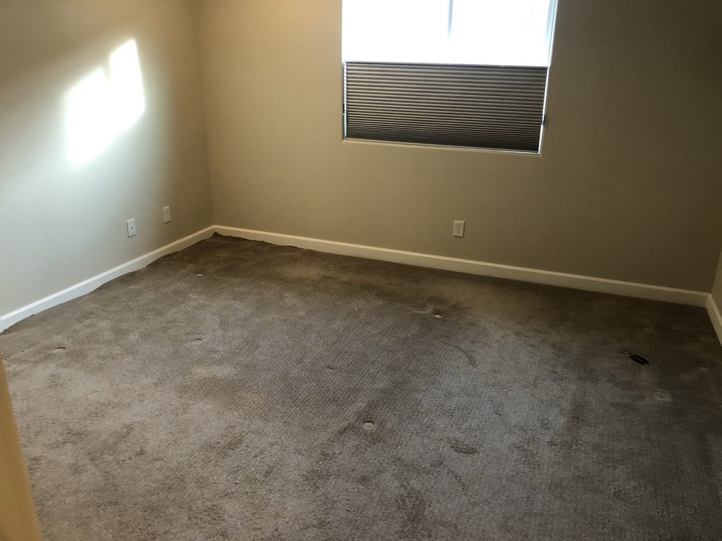

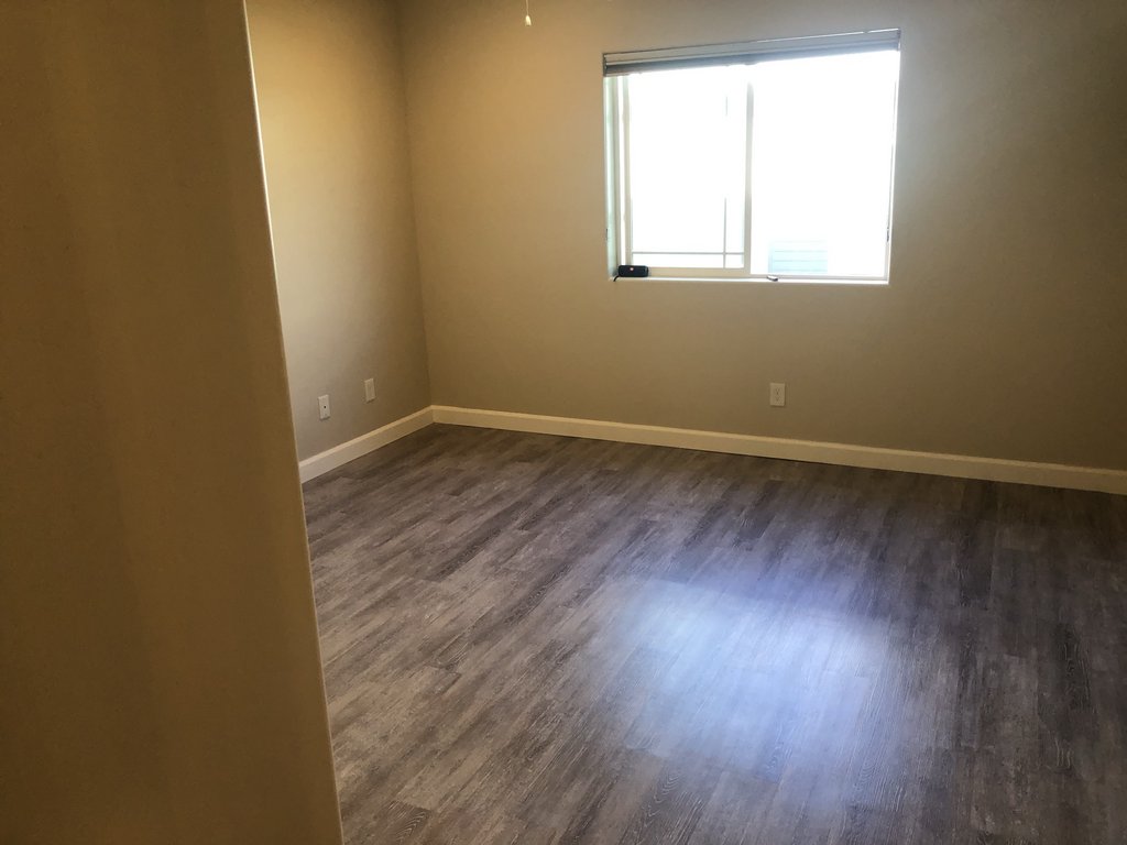

So, for Christmas we bought some vinyl plank flooring and I spent yesterday and today flooring the rooms. It came out pretty fantastic. I’m quite thrilled with the results!

Huge improvement!

Very nice! I have similar flooring in ~80% of my new house. I like it. Especially nice if you have pets, as it makes the inevitable hair very easy to vacuum up.
Picture of Redhookbklyn
Well done, sir.
Looks great!

Nice job on pulling the baseboards and replacing them after laying the floor. I hate that quarter round BS they put on to cover the fact they didn't pull the baseboards.

There were two tools that were quite helpful. One is the Zenith trim puller. It works quite well. That said, there were some places that they shot four nails into the stud, and the baseboard was a real bitch to get off. The trim pulled definitely made it a whole lot easier.
The other tool was the Milwaukee Oscillating Multi-tool. I took a scrap piece if the new flooring, set it next to the door jamb, and then used the multi-tool with the wood cutting blade and cut the jambs so the flooring would fit underneath. It worked out really well.
Just as well, I’m quite happy with how the transition between the bedroom and the bathroom came out. It was pretty cool as I cut out the piece and then attached it to a second piece, then laid out the non stick paper over the grip strip. Put the pieces in place and while holding them where they needed to be, slid the paper out so the grip strips could bond.

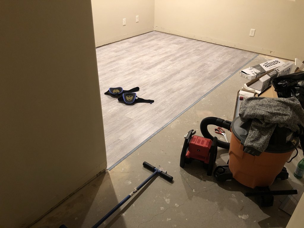

I would also include the knee pads at the top of the list of quite helpful tools. A group I work with has installed bunches of vinyl plank in "Harvey" homes.

Kneepads!

I thought someone dropped their bra!! :-))
