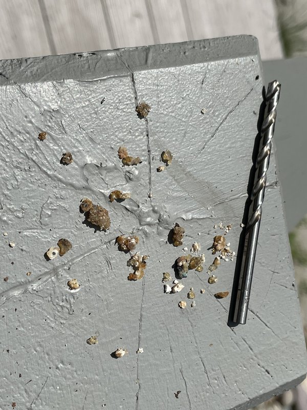

While the jet pump housing was at the machine shop, I found the source of my over heating problem, pictures below. The first picture is the J-pipe that comes off the exhaust manifold and goes into the muffler. Cooling water flows through the J-pipe then through three 1/8” hole into the muffler. Two of the three holes can be seen in the first picture. All three holes were blocked. The second picture shows the crap I was able to knock out of the J-pipe with a 3/16 drill bit for reference. There’s no way the bigger pieces got past the raw water strainer, they’re just too big. They look just like the crap I clean out of my parents’ faucets every year. Since it was used from my parents’ lift and flushed with their hose and water, I’m guessing that’s where it came from. The flush port bypasses the raw water strainer.
Now, I took it out this morning and it ran great. With 1-3ft waves, I really couldn’t open it up.
The threads on the housing are are bit loose due to the material lost from the corrosion. I’m going to fix this when I get back to Florida by installing stainless steel Time-seers with marine thread locker. I thought about using through bolts, but you wouldn’t be able to remove them with the whole assembly installed in the hull. There’s no way to get a wrench on the backside. Being able to take them out and removing the Venturi nozzle while the pump is still attached to the hull makes removing and especially reinstalling everything much easier. I spent 30 minutes trying to squeeze my hands past all that just to install the 4 nuts, washers, and lock washers on the studs for the pump housing.

Good catch realizing that the water used for flushing introduced that debris ahead of the strainer. Too bad the bolts sheared in that pump casting.
