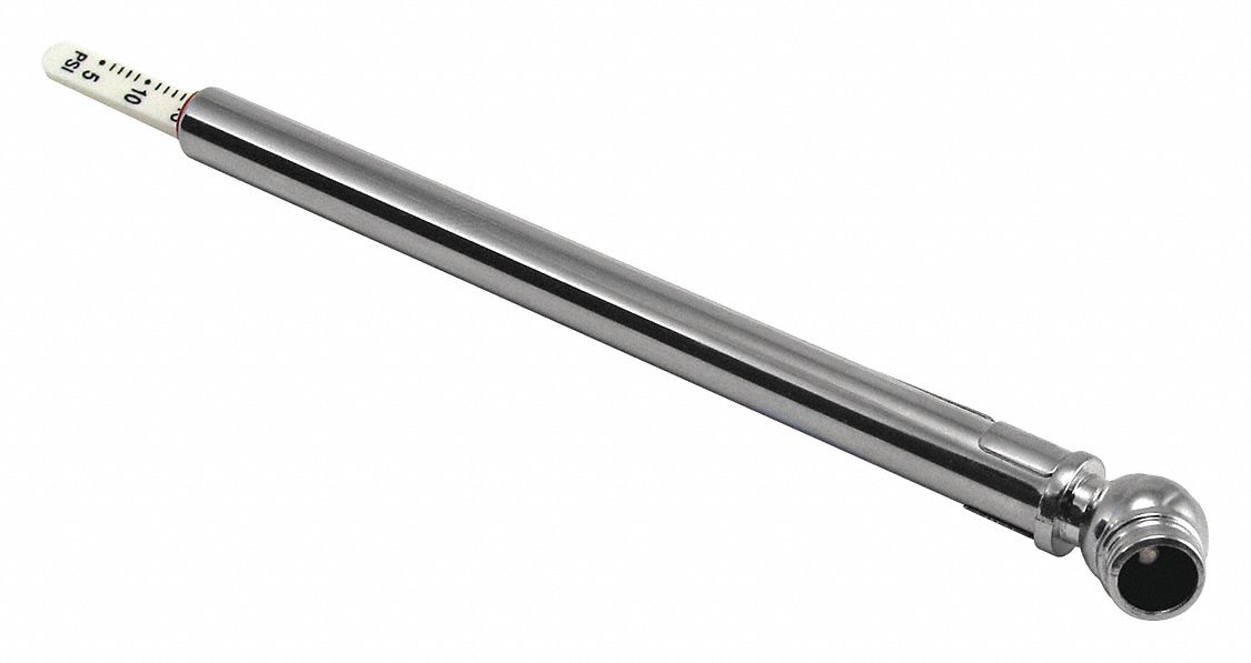

These have been around a long time.
As for the light, a small piece of electric tape will make it go away and is removeable in the spring.
