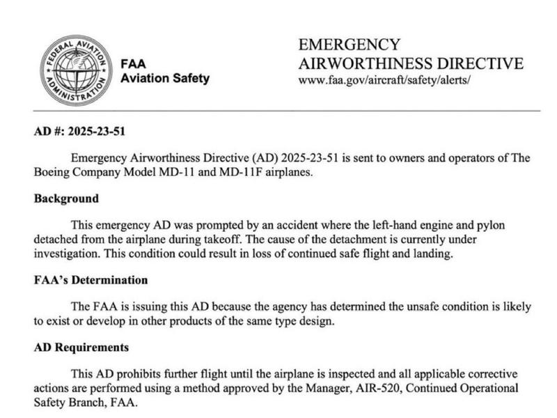

Looks like the FAA has grounded the MD-11 for now while inspections are done.
https://www.aerotime.aero/arti...leet-after-ups-crash

Amazing photos of the engine detaching after the plane started to rotate off the runway, no way back....
https://x.com/NTSB_Newsroom/st.../1991538483048116353
Posts: 28799 | Location: Gunshine State | Registered: November 07, 2008Reply With QuoteReport This Post
Looks like the engine did not suddenly lose power and fall off.
Posts: 15092 | Location: SWFL | Registered: October 10, 2007Reply With QuoteReport This Post

Appears to be similar to an earlier MD-11 crash which resulted in an airworthiness directive regarding the pylon mounting pins where the rear pin (or mount) failed, and the engine, at thrust, rotated around the front pins, over the top of the wing, detached, and tore the shit out of the wing as it exited.
Diagram of mounting pins; you can see where the failure of the rear mount will cause an upward rotation around the front mount.
Posts: 13719 | Location: Florida, Northwest of the Mouse | Registered: November 02, 2008Reply With QuoteReport This Post
Similar to AA 191? Engine detached & rolled over the top of the wing.
