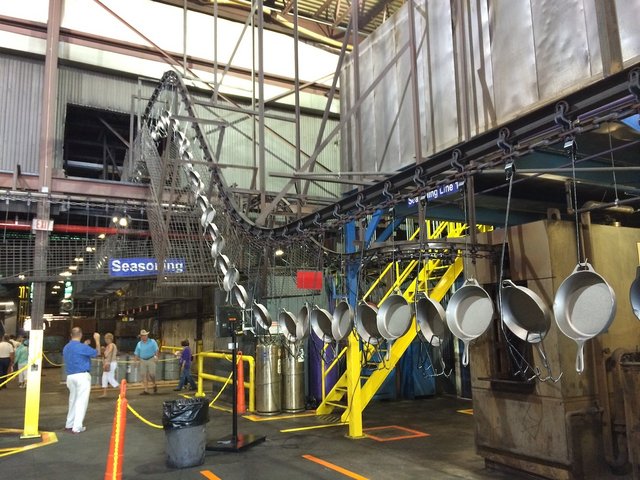

I'm sure someone will tell me I'm wrong, but I tend to think the seasoning they put on cast iron pans is only good for keeping them from rusting until you can put your own on. I would, and I have stripped that stuff off and started fresh with my own and done a few layers before I cook anything on it. Starting with bacon will give you a great foundation. Going straight to the eggs was a gamble. Big Grin
Lodge, made right here in good old Tennessee!
It's not the seasoning that is rough, it is the actual casting of the iron due to the texture of the casting sand they use and the lack of machining. I have toured the Lodge factory during the Annual Corn Bread Festival and I pulled the tour guide aside and grilled him about how rough their pans are compared to some others. He said it was "intentional" and it helped the seasoning adhere. At most all you need to do is smooth off the very roughest texture of the pan... or just let it wear smooth. It works fine.
Lodge uses one layer of Flax-seed / grape-seed. I watched them doing it assembly line style, in big ovens... looked just like a production power-coating operation if you ever saw that done.
