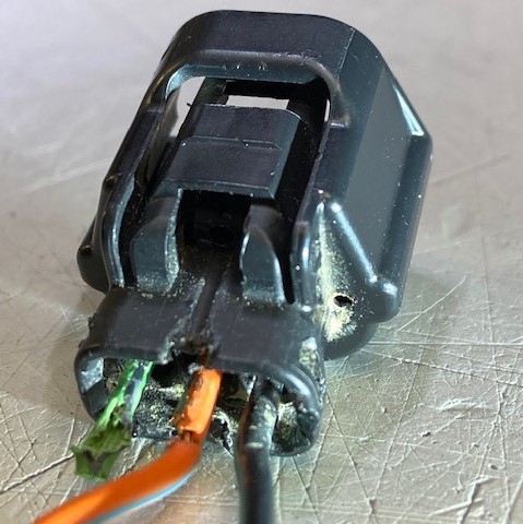

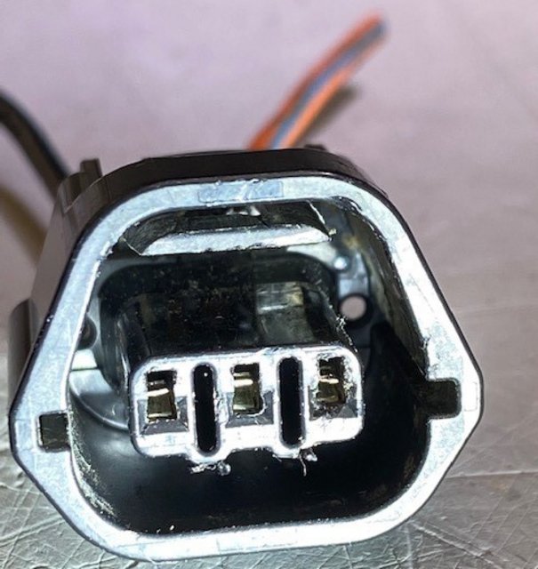

Good morning, SF. It looks like today brings another chapter in the "What's this connector?" book.
The pics below show a wiring harness connector on a friend's ATV. I'm trying to identify the connector so as to learn how to remove the terminals. I'm very familiar with Molex, Amp, and some JAE terminals and housings, but this one baffles me. I can't find a way to release the terminals from the housing.

Look above the connector, see that black tab?
It appears that needs to lift up to free the connector, a small flat eyeglass screwdriver can go in, lift and then pull the wire. You can probably go in from the wire side as well, push the wire a tad forward and lift the retaining clip. Should slide out.

If you don't find the answer here, I'd search the brand of ATV and connector and see what pops up.
Include the brand, model and year of the ATV here too and maybe that'll help us find the info.

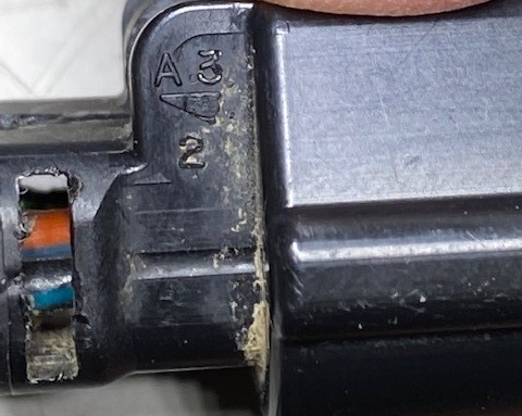

I couldn't tell from the photo but is that a part number on the top face of the connector? Maybe a magnifying glass would help you see if it's not clear.

Weatherpak I suspect.
Posts: 3895 | Location: Wichita, Kansas | Registered: March 27, 2011Reply With QuoteReport This Post
I work with car wire harnesses daily.
It's a yazaki connector, from the arrow above the 2, but I don't recognize the style.
Got a P/N anywhere on it?
HRK is generally correct, but don't go in from the back (wire) side.
Referencing the pic HRK quoted:
I don't see a secondary, but I'm used to white secondary locks. If that tab above the RH terminal won't lift up, it might not have a secondary & you can skip that step.
Push the wire in slightly.
Use a small screwdriver that fits easily between the top of the terminal and the plastic, can't be tight. Slide it along the terminal until you feel it stop, then lift/pry the tab up slightly & pull the wire out.

Proprietary design maybe?

My neighbor works for Yazaki. I'm sending him the picture now. I'll let you know what he says.
Posts: 1523 | Location: Ypsilanti, MI | Registered: August 03, 2006Reply With QuoteReport This Post
He didn't have an answer as to disassembly, but might have one laying around.
What's your end goal? Disassembly to reattach to the wires? Would a replacement solve the disassembly issue?
It's a Polaris ATV (I don't know yet which model), and I'm told it goes to a sensor on the carburetor. The mark at the top center of the connector (terminal side) is just a blank rectangle. The only numbers I can find are on the fifth photo I posted.

Yazaki! I didn’t think of them.
That's the method I'm familiar with. Prior to this morning, I just wasn't having any luck finding/feeling a tab that would move.
Found this
Yes, the intent is to replace the connector and terminals. The wires have been cut and we're attempting to rehab that connection.
We did manage to get the terminals out today, inserting a tiny-diameter probe and finally finding a tab to release them. Are fresh terminals and seals available? I'd love to be able to recrimp these leads and put it back into service.
