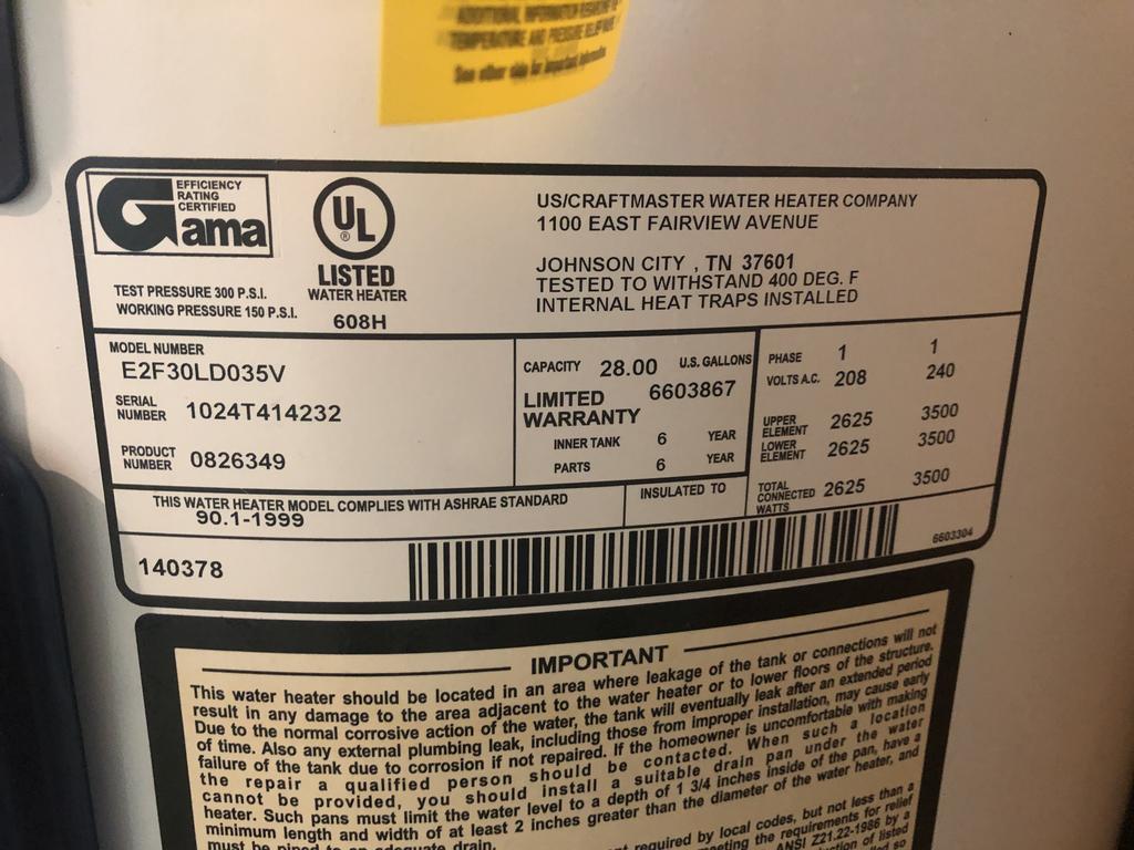

This is the water heater I have.
Is there something that will be a direct swap? Just swap the electric wires and water lines over?

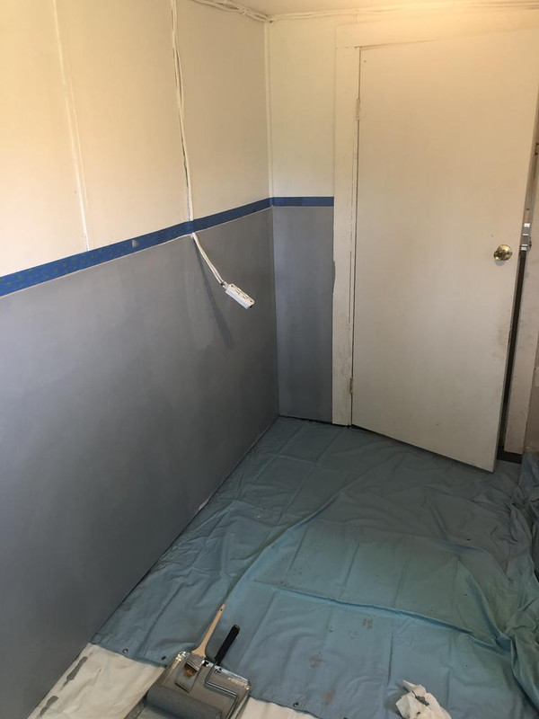

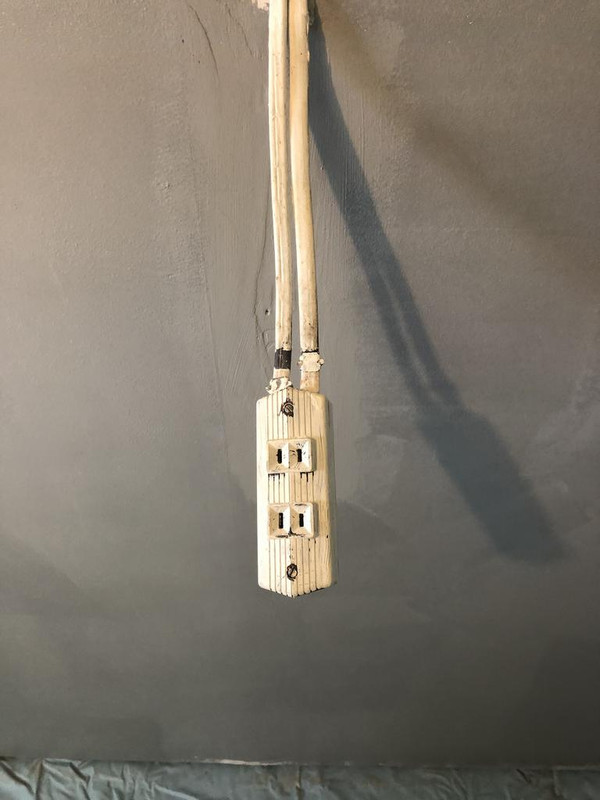

Next this is what the outlets look like
I want to lop off the outlets and run the wires in conduit and attach to the wall instead of the wires just being staples to the wall. And an outlet box to mount to the wall.
The wiring is adequate I just want to clean the look up a bit.

Am I seeing 120 volts electric wires on a 240 volt water heater? Need at least #10 wire, and that might be 10 or 12 wire.

I have a feeling that the wire feeding your existing water heater is not going to be large enough to carry the tankless heater . You'll need to check and see what the tankless one requires .
Those receptacles on the wall are concerning . What size and type of wire is there now ?

A small electric tankless water heater would be 18kW or 5 times as much electricity as your current water heater. Your probably going to need 2-40 amp breakers and 8 gauge wire.

What size wire and breaker. If it's that old it may be of a double 20amp with 12g wire? Is there a ground wire?
Anything new will be hard wired which isn't hard if your current wire is up to it. You could just put that wire in a junction box and feed out with some extra wire into the new water heater.
The Amp draw on the new water heater and what you currently have for wiring will decide what works.
Looks like two sets of wires which is likely wired on a double breaker(or two singles considering the age) for 240v. Those are old non-grounded outlets and not what you will see today or up to current code. I'm guessing they wired two plugs into the old WH and plugged it those outlets.

Are you saying that that receptacle hanging off the wire is what is powering the existing water heater?
If that's the case probably needs some more consideration.

The water heater is proper 240 wiring. I posted the sticker showing the water heater showing the specs hoping there is a tankless that is similar. Probably looking at more of a point of use unit like this
ECOTOUCH Electric Tankless Water Heater Point-of-Use Hot Water Heater Digital Display for Energy Efficiency 5.5kW at 240V, White https://www.amazon.com/dp/B07M..._api_i_NjF3CbEP924A8
As for the outlets looking to keep the wire but put it into some conduit and add a new outlet box.

All kinds of problems here. First, linked unit is for sinks, you'd need one twice the size for a shower and it would need a dedicated circuit for shower as well as one dedicated circuit for every two of the sink sized units. Electrical costs alone on that would be excessive, additionally the cost per unit needed as well as drywall and paint would destroy any potential electricity savings. Why not just flip off breaker when you aren't there?
Next for electrical consideration, you will very likely need a larger electrical service if you want whole house instead of point of use, they require two to three 40a 240v circuits.
As for the wiring/outlets abandon all and rewire. That shit is beyond illegal.

Wiring may be from the 1960's. Reusing not a good idea because it is probably brittle and bending could cause insulation damage.
Tankless electric is usually a long payback replacement option due to need for modernized/upgraded panel and wiring requirements.

I have seen water heaters like yours on a #12 wire 20 amp 240 volt circuit. The tankless you referenced must have a #10 wire 30 amp 240 volt circuit. Please check this, if ok it may work as you want it to.
Tankless does not play nice with hard water. Read up on this. Kentucky has some of the hardest water I have ever seen.
My advise is to leave the outlet wiring alone until you can replace all of it.
