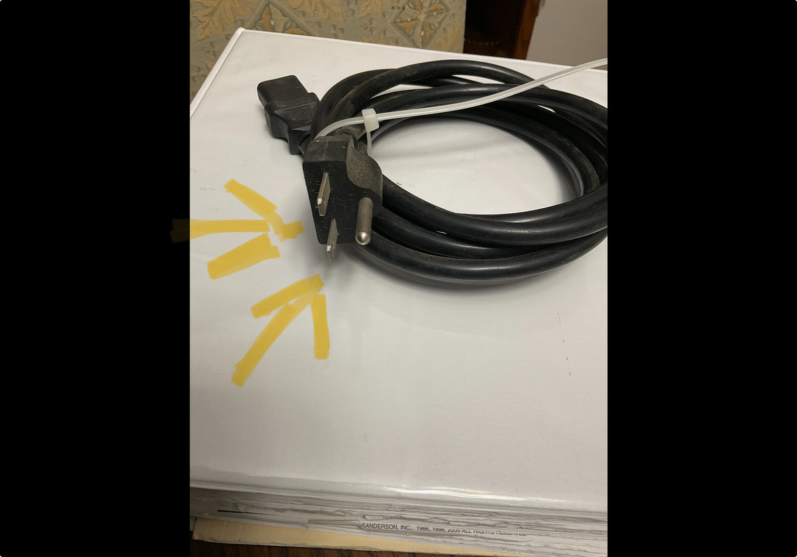

This was in a box load of goodies the wife brought home. Any idea what it goes to?
Thanks folks.

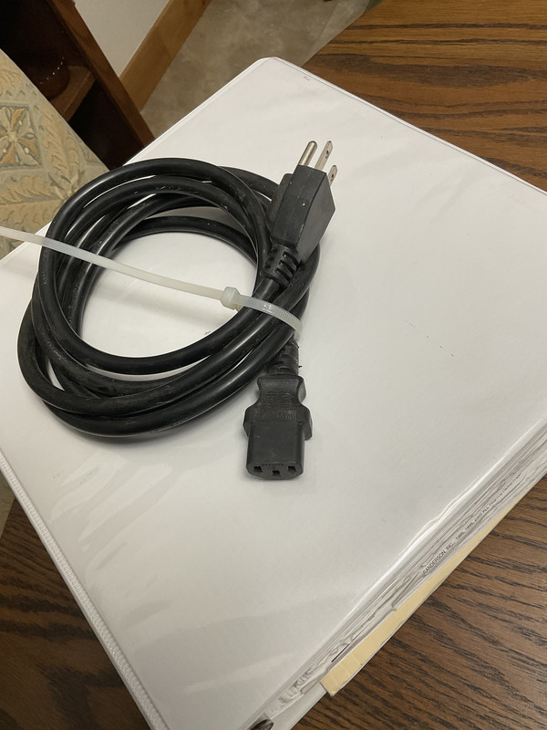

Computer monitor, or maybe a Tower desktop.
Posts: 18783 | Location: Spring, TX | Registered: July 11, 2011Reply With QuoteReport This Post
Those type of power cords are used on larger home electronics. Often seen on desktop computers, computer monitors, TVs, pressure cookers, stand mixers, etc.

Those pins are rotated 90° though.

A number of computer related products. Desktop, monitors, printers are a good start.

Exactly...I haven't seen the 90 degree offset like this before..thx.

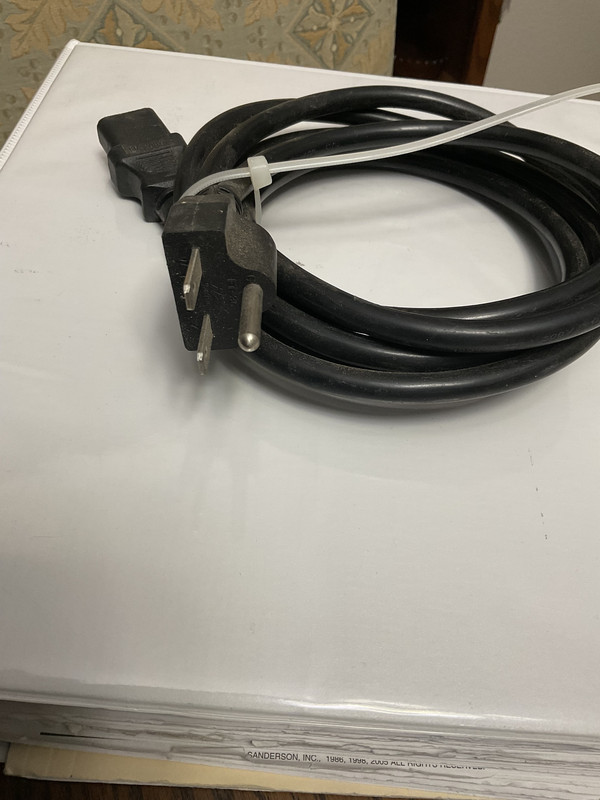

NEMA 6-15P to C13 power supply (Straight blade 15A 250V)
Exactly. Smile

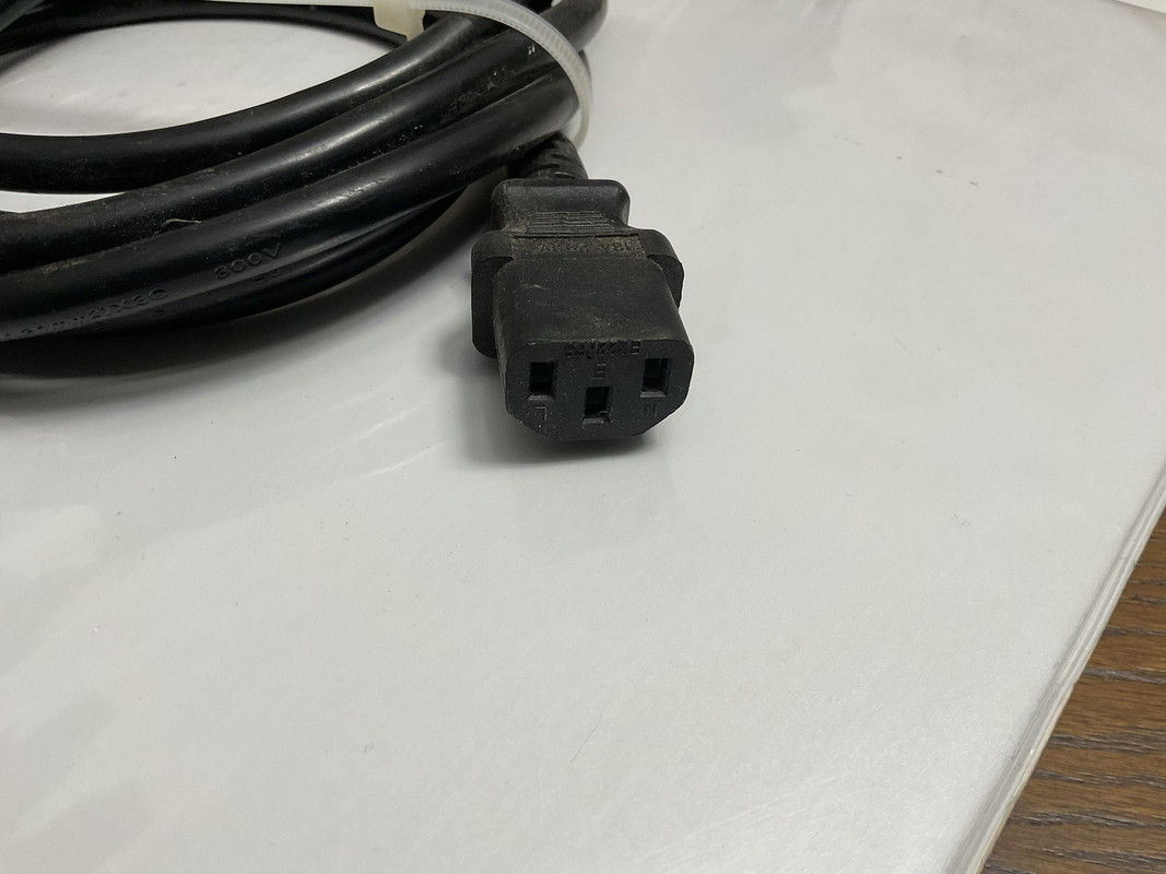

Needlessly long for one, but the female end looks just like that of my coffee percolator.

As stated above, that plug is a NEMA 6-15p which is made to fit 240 VAC 15 amp receptacles. You may be thinking of a NEMA 5-20 which is a configuration for a 125 vac 20 amp receptacle featuring two straight blades with one of them being perpendicular to the other. The receptacles for these feature one side that is shaped like a sideways 'T' and will allow either a vertical or horizontal blade to be inserted in order to accommodate an appliance or equipment that the manufacturer rated at 20 amps and must be supplied by a 20 amp circuit.
A NEMA 5-20p and a NEMA 6-20p may look the same (one blade vertical and one blade horizontal) but have the blades reversed so that you cannot insert one into the other.
