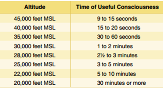

Altitude / Time of Useful Consciousness
45,000 feet MSL / 9 to 15 seconds
Okay, I’ve seen this sort of chart before and puzzled over it, but I still have a question.
Even at the altitude where I live and despite being in my 70s, if I suddenly stop breathing, I can go 20 seconds or more without having to gasp for breath. When I can’t hold my breath any longer, I’m still far from losing unconsciousness. Plus, according to what I can find with a quick search, at 45,000 feet a breath would give me about 16% of the amount of oxygen I would get at sea level (and nearly 25% of what I get here), unlike the 0% that I get when I stop breathing. I would think, therefore, that that bit of oxygen would keep me going for even a little longer.
So my question is, What’s the basis for the 9 to 15 seconds of useful consciousness figure? Is there something about being at really high altitude that depletes our oxygen saturation faster than just not breathing at all? It’s not something I’ve noticed where I live, but I get 69% of sea level oxygen per breath rather than 16%, so I could be ignorant of something.
It’s not that you stop breathing. You keep on breathing but there isn't enough oxygen to keep you going. I’m the most experienced victim on this Forum at this, after 7 years since being diagnosed with pulmonary fibrosis. Now even at less than 1000’ above sea level, I must have supplemental oxygen to do much moving around, almost constantly. I would pass out at a few thousand feet without supplemental O2. Your lungs take the oxygen and get it into your blood stream to power your muscles and systems, as I understand it.
Time of useful consciousness means “the amount of time an individual is able to perform flying duties efficiently in an environment of inadequate oxygen supply.”
When I did the high altitude chamber course at Edwards AFB, after most of the day of lectures, etc., we were put in this chamber, seated, given O2 masks, and slates with a number of simple problems to work out. The technicians ran us to various altitudes and finally to 25,000’ where we were to remove our masks and work on the problems on the slate. When we felt we were losing concentration, hopefully before losing consciousness, we were to put the masks back on and breathe normally. At between 4 to 5 minutes, some started replacing their masks. I made it a bit further but somewhere around 6 minutes or so, I went back to the mask. The fellow at seat no. 7 kept on, concentrating on his slate. The corpsman called out, “No. 7, how are you doing?” No response. “Hey, No.7, put your mask on.” No response, he kept head down working away. “Hey, No. 7, put your mask on, you’re going to die!” Finally the corpsman went over and put the mask on. No. 7’s lights were on but nobody was home!
TUC gets a lot shorter at higher altitudes.
