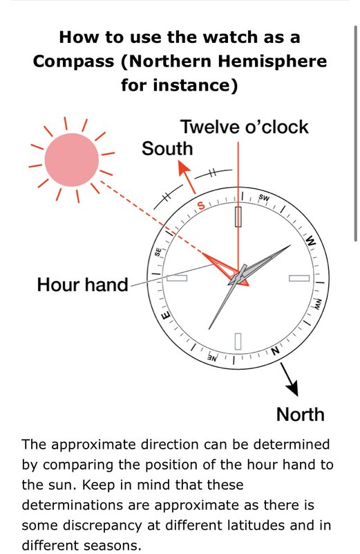

Another fun watch fact: You can use an analog watch with hands as a compass in the northern hemisphere.
