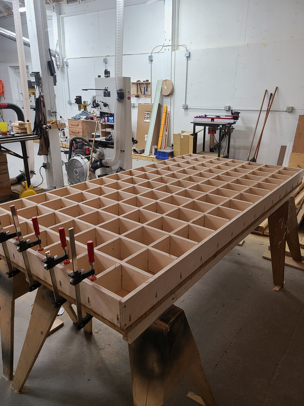

Here is one I built for my shop. It is a torsion box, so it is dead flat and that's important to me building furniture. I used some leftover 6x6 timbers for the legs and support structure, which is assembled with mortise and tenons and pegs. The two ends of the support structure are connected with a solid sheet of 3/4 inch plywood which makes it extremely stable. I used plywood and some glued up pecan flooring to form the outer rim. The overlapping 3/4 inch plywood grid is glued together then screwed and glued down to the 1-1/4 inch top of laminated MDF. The bottom is a sheet of 3/4 inch plywood glued to the grid. The spaces on the vise end of the bench are filled with solid SYP glued in to make a solid base for the vise. This one is 4' x 8' but you can size it any way you like. This bench is based on a design by James King who is a Youtube woodworker and his how-to videos are excellent.

If it is in the budget I highly recommend one of the SAWSTOP saws. They do make portable saws as well as the stationary cabinet saws. They cost a little more but the peace of mind from the safety system and quality of these saws make them worth the money.
Hayes,
That's a good looking bench but beyond me at the moment. I don't have a pocket screw jig or sufficient clamps to put a torsion box together. I do like your solid frame and I'm going to do something similar to the vertical plywood piece running vertically down the middle. Have to fit it around the compressor and other tools.
Do you have a brad nailer?
When I built the table top for my CNC machine, I used glue and a brad nailer to build the torsion box. My build process was similar to: How to build a torsion box assembly table. It's dead flat and very heavy.
