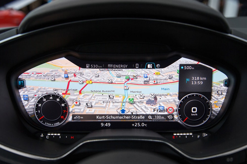

What I mean is that a lot of the digital dash’s I have seen have a wide array of colors and are very configurable. With navigation on you might have 20 different colors at any given time. Also with a digital dash since the entire panel is illuminated there isn’t a harsh or blinding color that stands out, it’s a milder transition.

Yowch! Could that be more distracting?
No way would I want that up when I was driving, particularly at night.
Right up till you look outside at night. Wink
To be fair at night it’s a black background and not as brightly lit. If you think that’s crazy wait until you see what rear view mirrors will be in the next 10 years. Here’s a hint, not mirrors.
