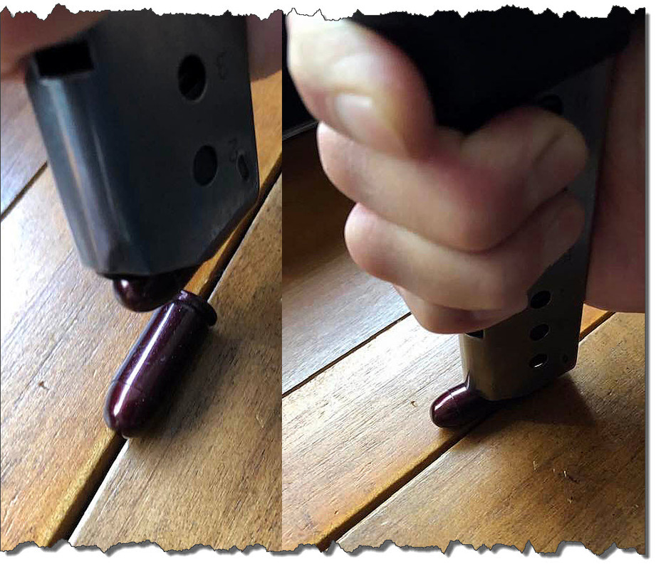

I had a similar issue with my P226 back in the early 2000's at that time my 12-13 year old Son was at the range with me and he took/showed me a different approach.
He laid the round(s) that wouldn't go in on the wooden bench (though this will work if you have a mat or something that won't allow the round to slip around).
He then turned the magazine upside down and pushed down on the mag to start the round, he then pushed the mag forward to slide the round in/seat it. We used this method a number of times and left the stubborn magazines sit as well when we got home... they eventually loosened up & in the future we were able to load them without issues.
Very clever. Thanks.
