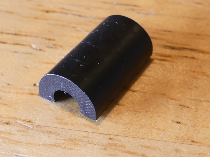

Would someone post a picture and dimensions of the take down tool.
Thanks in advance for the help

I'll try to do that tomorrow, though I didn't find that little plastic "tool" very handy.

Here ya go, sndbggr1484. Sorry for the delay, but better late than never, eh?
Length: 0.664 in.
Diameter, outer: 0.395 in.
Diameter, inner: 0.183 in.
If you look closely, you'll see that it's just slightly C-shaped in cross-section, so it'll snap on and off the exposed guide rod.
It's kind of a PITA to get off. One of the things that makes the tool I note, above, so much easier. (It uses a small magnet to hold it in place when there's no recoil spring pressure on it.)
Thanks for the picture but you might be right that the one in the link you listed would be the better way to go even with the cost.
Thanks again
