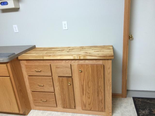

I appreciate the massive 4x4, 2x4, and 2x6 suggestions, but I'm actually going to a fair bit of trouble to remodel the aforementioned room to look good. So, while I'm not interested in form without function, neither am I interested in an ungainly-looking beast of a bench suitable for hammering-out car fenders Wink
How about a seriously overbuilt cabinet?

Picture of MikeinNC
^^^that is a thing of beauty

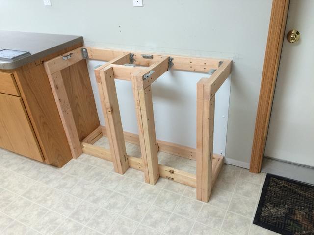

Ensigmatic...I know you don't want the 2x4 approach, but I have to say I built a frame out of 2x4's and Simpson Strong-Ties with the table-top being two (2) pieces of 3/4" plywood glued and screwed together to make a 1 1/2" thick work surface. Once this was all put together (top secured to frame-work with Pocket-Hole Joint and screws from underneath), I brushed on about 3 coats of Sanding Sealer on the 2x4 supports and underneath the work surface and then applied about 5 coats of Poly Varnish to the top and sides of the work surface. My bench measures 3'x6'.
I looks good (doesn't have that "raw" lumber look) and it's probably the most sturdy thing in my house. Oh...and there's a bottom shelf of 3/4" plywood that is coated in Sanding Sealer as a well. After seeing YouTube vids of guys with a bench that "flexed" BADLY when they pulled the handle on their press, I vowed mine would be solid as a rock; and it is!
Just mentioning it as a low-cost alternative...
