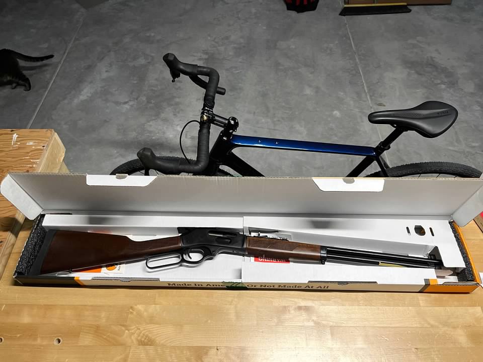

After many decades of sitting on the fence, I decided to commit to loading 30-30's for the fun of it. Maybe it's from watching the Yellowstone series, not sure. Anyway...
My Christmas Gift to me this year was a new Henry Lever Action and now have the components coming for my Dillon 550.
What I'm not clear on is a good load for a 170 soft point bullet. Think I want to stay with Hodgeon products since I'm using a progressive press.
Also, any good tips and tricks on reloading rifle rounds would be appreciated as this is my first venture into the rifle reloads.
Thanks.
Picture for bragging.
