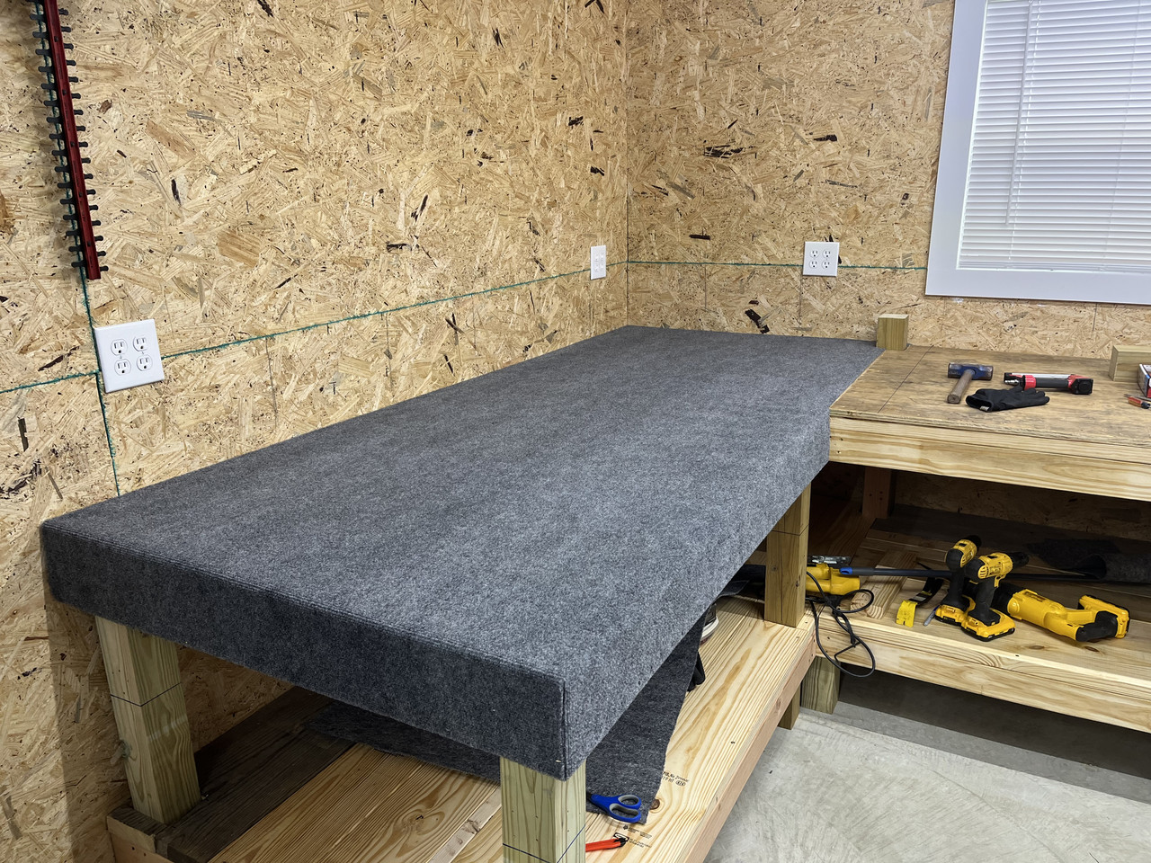

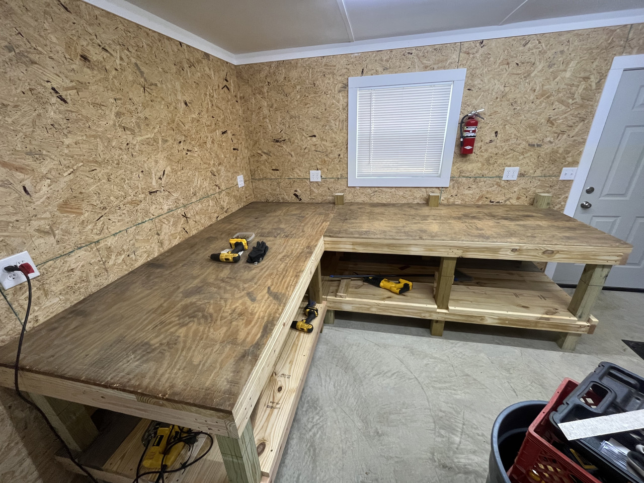

400m - Moved six months ago and just had my shop finished enough to allow me to start my reloading bench and work bench last week.
The gray carpeted area will be my reloading area and the raw wood area my work bench. Trying to decide what to put at the transition area to maintain minimal separation between the two areas.
Mine is a current work-in-process - My Frame is built with 4x4 legs, 2x4 and 2x6 framework. The top of the reloading bench consists of a solid top of eight foot 2x8’s topped with a 3/4” piece of plyboard. Finally, covered the top with indoor/outdoor carpet. Next comes rear shelving and then machine mounting( Dillon RL1100, Dillon XL650, Rollsizer Depriming Machine, RCBS Rock Chucker). I am a lot OCD so this is a slow process.
As you can see the lower shelving is built with 2x8’s. This will be where I store my reloading supplies.

^^^^^^^. That's almost identical to mine, except I used 2x4s (two on the corners) rather than 4x4s. I like the idea of the carpeting. Might have to look into that.
Posts: 23142 | Location: Montana | Registered: November 01, 2010Reply With QuoteReport This Post
Purchased it at Lowe’s for $0.63 a sq foot. Took $26 to cover what you see. Only disadvantage is that it only comes in 12’ width. Took the nematic stapler and stapled the heck out of it.
Had on my last reloading bench and loved it.
Also, the dark boards you see on the bottom shelf are a couple of old 2x12’s that were left by the construction company that were starting to split, so I use them as shelving material.
The three-quarter inch ply board tops are dirty and discolored because they were previously warehouse racking at the company where I worked and they were throwing those out, so I grabbed them also. Wood is to expensive now days to walk away from if it is free.
Posts: 3661 | Location: North Mississippi | Registered: December 16, 2004Reply With QuoteReport This Post
