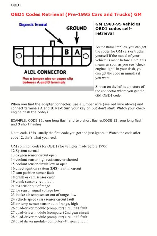

GM obd-1, you don't need a scan tool. Just connect a/b on the obd plug, with a short wire or paper clip.
Key on, the car will display codes with a series of flashes on dash. 12 will be first number shown by one long flash (for first digit) then two short flashes for second digit (12). Code 12 means your in diagnostic mode
The code will repeat 3 times then next code will flash. When all codes are shown,12 will come up again.
Then look up the codes.
Plenty of youtube videos.
You can find an old snap on MT2500 scan tool with adapters and cartridges on flea bay. MT 2500 covers alot older cars, but with GM's self diagnostic feature its not necessary

Not going to get block learn/interrogator with flash codes or any other live stream data

Yes, a scan tool is needed for live data.
There is 99 codes, available I only posted a partial list. Usually enough to figure things out. Battery disconnect will clear codes and start a relearn.
