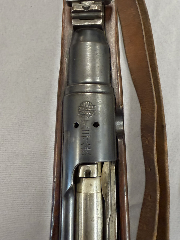

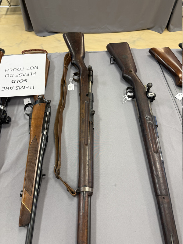

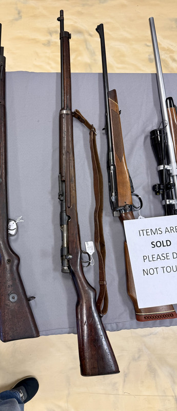

I just went to a local gun auction and won a Arisaka type 38 in 6.5 JAP. I have always kind of wanted one after my grandpa had one years ago. I don’t know if he had a type 38 or a type 99, and I don’t know which is more desirable, but I have heard that the earlier type 38 rifles were built better. Ammo seems pretty expensive, but I figured it would be at least a couple bucks a round. It has a lot of dings in it, but the overall fit is very good and it seems to be pretty solid. The serial number is in the 438,000 range so I think it was built between 1915 and 1920. It was said that this rifle has one of the strongest actions of any bolt gun fr it’s era so I would assume it’s safe to shoot with any current production ammo.
It’s missing the cleaning rod, dust cover, as well as the monopod, but I don’t care. It still has the chrysanthemum stamp, but there are three lines through it so I guess it could be worse as many were completely ground off. I assume this means it was decommissioned and not a battlefield pick up.
One question I did have was to the finish on the stock as I have read where some of them have a URISOL based finish, which is very problematic if you were to ever sand the gun stock as the dust is much like poison sumac, and will irritate the skin. I also heard that the early ones were coated in boiled linseed oil instead so I don’t know which mine has? Either way I would assume as long as I just use it normally and don’t sand it I should never have a problem, right?
I would love to know more about this rifle as I have just started to do more research, and if you own one, share it and your story about it, please.
Here are a couple of quick pictures I took. I actually have to pick it up this week as I just won it yesterday.

There should be an ‘arsenal’ stamped that designates where it was made.
This symbol will be on the left side of the receiver, next to the serial number.
Based on the 430k serial, it should be the Koishikawa Arsenal in Tokyo (the most common arsenal) whose symbol was a series of 4 interlocked circles representing a top-down look at a stack of four cannonballs.

The workmanship in the close-up (center photo) is very evident.

Yeah it has the cannonballs pattern like you showed Rogue.
So is it boiled linseed oil or Ashuri coated?

They transitioned from BLO in the early 30s. So likely BLO, unless the stock was replaced. But it looks like BLO.
If you're planning to refinish it (please don't), keep in mind that the BLO used back then was actual linseed oil that was heated, whereas the "BLO" sold in stores today is a little bit of oil mixed with a bunch of petrochemical additives, thinners, and drying agents. You can still get pure linseed oil online, often through art supply or woodworking stores and sold as raw linseed oil or polymerized linseed oil, but it takes quite a bit longer to dry than the modern quasi-"BLO" from the hardware store.
