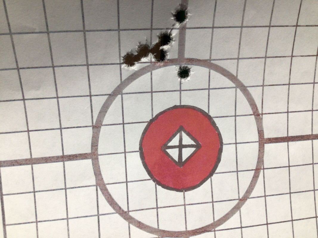

My hand loads after barrel replacement. Those stringers are all me. It was 30 degrees here in Florida when I shot the gun.

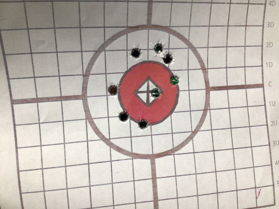

Remington Corelok 180gr after barrel swap. The original barrel shot the ammo better, but again, it was freezing and I was shivering . I know I can tighten those up.
Remington Corelok 180gr with original barrel 100yds
