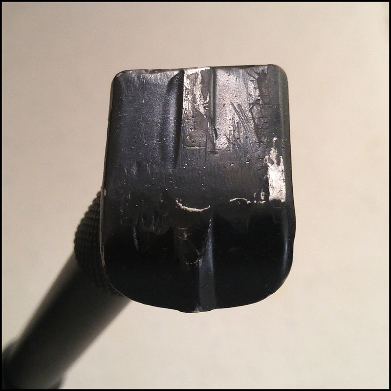

Gentlemen, I am looking for suggestions on how to make the feet on my rifle bipod non skid. Durability is a must. Right now, the feet are smooth and slippery. I would like to have them dig in a bit vs sliding on the shooting bench or any other surface. I don't want to have them having a spike.
I was thinking of finding some type of rubber material and use some sort of adhesive for the project. I am having a hard time finding any rubber material.
Any other suggestions?
Thanks,
Mike

Nonskid stair tape?
If you don’t want something as aggressive and abrasive as that, there are various types of thin rubbery shelf and drawer liner that would increase friction. I have found the various Shoe Goo adhesives to be useful for attaching that material to surfaces, even fabric.
6.0/94.0

A few dips in PlastiDip from Home Depot, Lowe's, WalMart?

I think the problem is getting and keeping anything to stick on the bottom.
I like the Plasti- Dip idea (a few coats).

I agree. I think Mark nailed it. I just watched a few youtube videos on the plastidip. I am intrigued.

Kind of similar to the Plasti-Dip idea, you can buy two-part silicone rubber or urethane rubber mixes.
You could make little molds (could probably be as simple as small plastic cups or a folded up piece of aluminum foil that you coat with vaseline), stick the bipod feet in the molds, and then pour the mixes silicone/urethane rubber in. Wait a bit and your bipod feet will be encased in a block of rubber.
I haven't done it personally, but I've seen it done and it's pretty easy. Smooth-On has a good reputation for their silicone and urethane rubber products.
Urethane would probably be more durable.
If you didn't want to go all the way to casting your bipod feet in blocks of rubber, Smooth-On also makes brush-on urethane resin products intended for coating stuff.

Gentlemen, thanks for all of the great ideas. I am going to try the plastidip route first. If it turns out that it is not durable, I will move on.

I happened upon a local hardware store today. Lo and behold what I found.
https://www.grainger.com/produ...ECS&cm_vc=IDPPLARECS
Exactly what the doctor ordered! I just need to find the best rubber cement.
