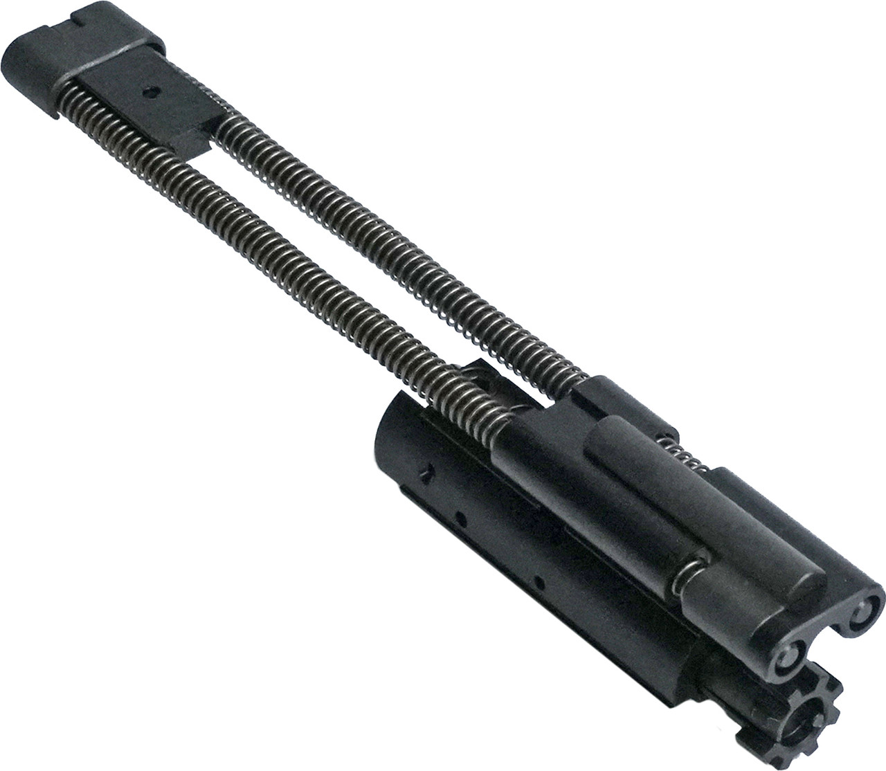

On rifles like the Dissent, it's a different bolt carrier system based around the Armalite AR-18, with dual springs above the bolt carrier that compress against the inside of the upper receiver, rather than a spring and buffer inside a buffer tube and the BCG partially leaving the receiver during travel.
But yes, the main thing you gain from this is being able to attach a folding stock, and shoot with the stock folded. You also don't get the typical AR-15 "sproing" in your ear.
(The AR-18 was initially designed as a cheaper, simpler, and easier to manufacture rifle compared to the AR-15, and this represents part of the simplification as you didn't need the buffer tube and threaded forged receiver, just a square stamped and welded receiver.)
