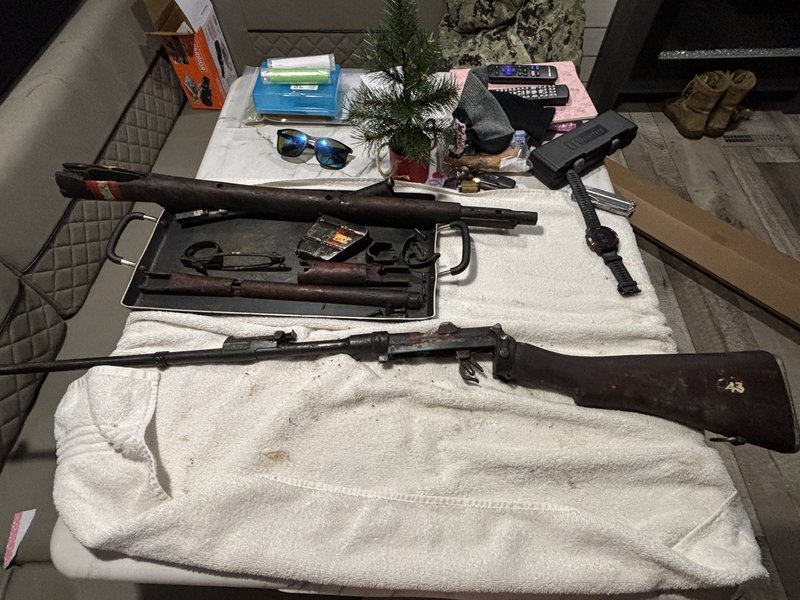

Starting breaking down the drill rifle this evening. Ran into a snag on the buttplate, one screw was so worn from use it had no groove left for a flat head to grab. I’ll drill it and use an easy out tomorrow. You can see how gummed up it is. I’ll clean everything up really well and take y’all’s advice on the wood.
OP: Enfield Drill rifle that Rogue pointed out to me finally arrived. It's not caked with cosmoline and crud but it’s carrying a good bit. I'm good on the metal parts cleaning them out. I've been doing a lot of that lately. With regards to the stock, I'm reading all sorts of stuff online, acetone, mineral spirits, easy off, heat gun.
If I'm planning on sanding it and refinishing in tung oil, is there a way that's better than another? I do realize that if I soak it in a solvent of any kind I'll need to dry it out for a while before doing any additional work on it. I'll probably do some oil, 600 grit, rub, repeat on it for 5-6 coats once its all cleaned up.

Garbage bag in front of the space heater is working well. Got a couple more rounds to go.

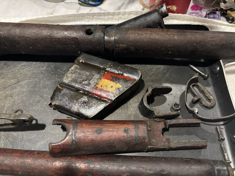

Next solution needed is the best way to remove this paint from the drill rifle furniture without harming the finish. As I’m cleaning it, I’m realizing the wood has a great color, that red that comes from the age and oil on surplus rifles.
I don’t want to ruin that, so how can I get the paint off without having to refinish the whole stock?
You can't, IMO. Anything that's strong enough to effectively remove the paint will also remove the oil finish.
You can try a judicious and accurate application of citri-strip or something painted on only where the paint is, and see if you can get the paint to bubble/flake off without too much removal of the underlying finish. But IMO there'll be a lighter spot there once the paint is gone. No biggie
Posts: 3786 | Registered: February 27, 2013Reply With QuoteReport This Post
I would also expect that even after the paint is stripped, even if you strip the whole forend that you'll still be able to tell where the stripes were unless you pick all the paint out of the pores of the wood and/or sand the forend.
Posts: 1133 | Location: Midwest | Registered: April 13, 2013Reply With QuoteReport This Post
Yep.
So leave the paint. It's part of the history anyway.

Dab straight simple green on the paint a little spot at a time and see if it will bubble up the paint, if it gets on the wood it’ll remove the oil and leave it super clean(which is not what you are going for)

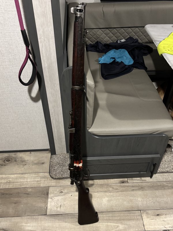

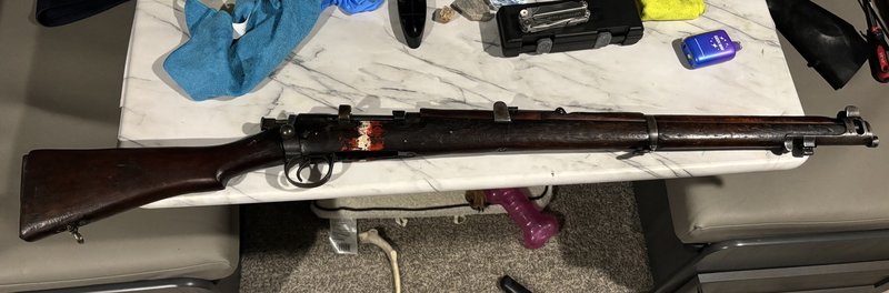

All done.
Got a couple small parts to buy form numrichs, plus a little wood filler on the buttock screws outta do it. I’ll clean up the magazine later, should be 4 total. Perfect for a chest rig set up!
Before:
After:
Posts: 8131 | Location: Wisconsin | Registered: August 10, 2009Reply With QuoteReport This Post
Much better!
Now you just need a P1907 bayonet and a P1908 web sling for it.
Posts: 35655 | Location: Northwest Arkansas | Registered: January 06, 2008Reply With QuoteReport This Post
