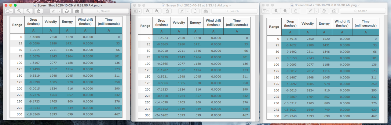

Picture of Ironmike57
Man, I can't see out to 600 yards! If it was a bolt gun, I would consider it. The 5 inch high at 100/150 yds is crazy.
The AK is currently set for 50/200
Do you mean 50/100?
A 7.62x39 AK doesn't zero at 50/200 like a 5.56 AR does.
But you can do 50y/100m or 25y/200m.

Rogue, you are correct. My mistake. I have been looking at too many numbers lately.
