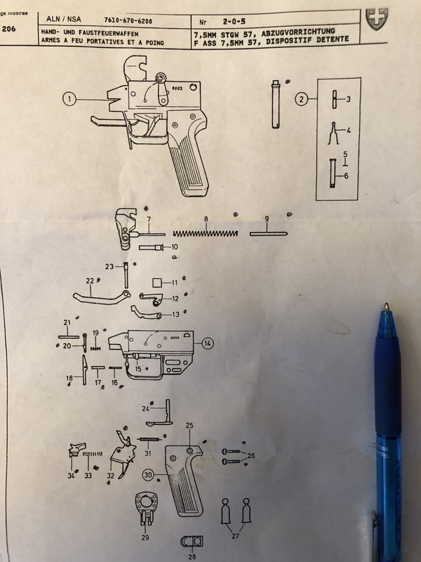

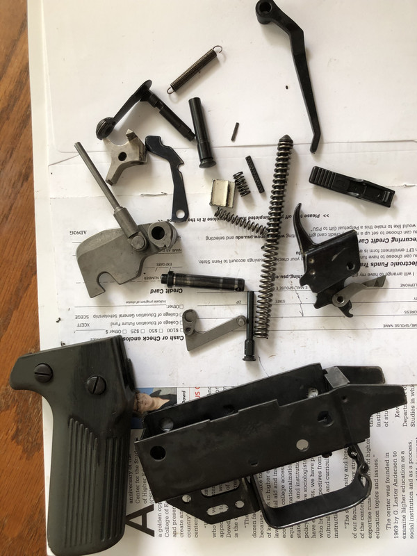

I have a completely disassembled Swiss Stgw 57 grip assembly. Does anyone have detailed assembly instructions? With pictures sure would be appreciated.

I hope this will help
https://www.swisswaffen.com/fi...t-1/agzr56s44vo7.pdf
biggerhammer is another source.

Dan, I'm not aware of a video, but check out Swisswaffen. There are various pictures of the trigger group of a cutaway model. Googeling for "Stgw 57 Abzugsgruppe" will bring further details as well. A PE or AMT group is almost identical also.

How does one compress the hammer spring (#8) so that the tip of the spring rod (#9) can be slipped into its seat on the back of the frame box (#14)?

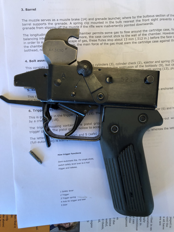

Well, I figured out how to compress the hammer spring. After five hours I was able to completely assemble the grip assembly.
After reviewing all the inter-web photos I could find, I have determined this grip assembly is for a 510-4 and most likely from Chile.
I needed to make a slave pin to keep the sear (#34), sear spring (#33), and trigger (#32) assembled when inserted into the grip assembly. Compression and positioning of the hammer spring was a real bear. I did it with vice grips, screw drivers, and pliers.

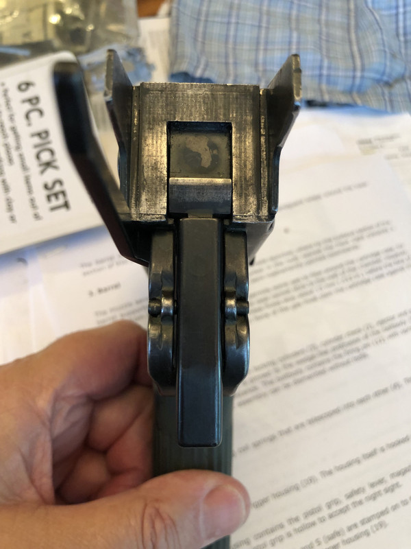

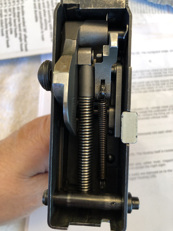

Here are some pics for your enjoyment;
These are the parts that I started with.
Completed left view w/slave pin, hammer down.
Completed right view, hammer down.
Top view, hammer down.
Top view, hammer cocked.
Front view.
