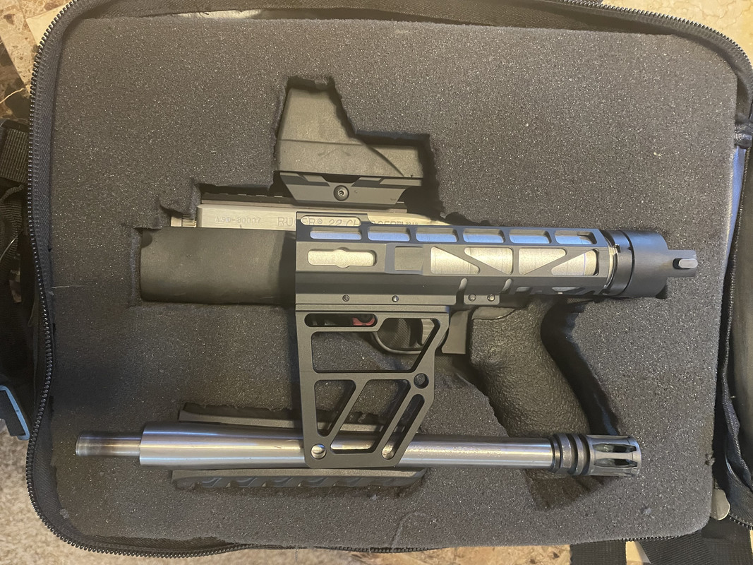

I posted a recent thread with my short barreled SBR 10/22. I got a free tax stamp for it, but with such a light, recoil free gun, I haven't gotten around to replacing the stock yet.
As to your concerns about reliability, I've had zero issues, I don't think I've had a single failure to extract or feed. I've only shot it suppressed, so that probably increases back-pressure sufficiently to make it pretty similar to a full length rifle, to the extent it matters.
As Smudge says, with a short enough barrel, even standard ammunition will be subsonic. I have a six inch barrel. I've had no reliability issues with cheap ammo.
My only warning, which I covered in my thread, is that if you want a chassis longer than the barrel, with a recessed suppressor, the thinnest suppressors are larger than a standard bull barrel, so some chassis will need some work to fit, as mine did.
It is hella fun. Keep us posted of your build pics, this class of gun is about as cool as it gets.
