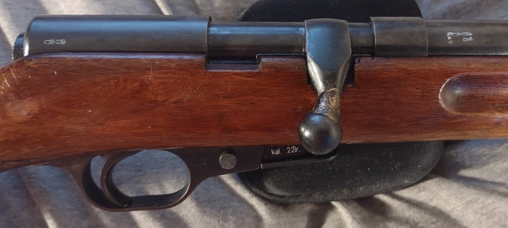

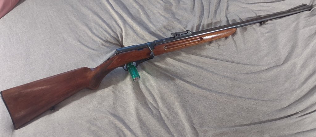

Picked up a really nice Walther Model 1 semi auto/bolt action rifle for a great price. Most I've seen are overpriced and possibly broken. I ran 2 boxes of Norma Tac-22 through it Sunday. Had some dud rounds [Norma seems to be hit and miss depending on the lot #].
Had problems in semi auto, only got 2 shots in a row out of 50 rounds. Didn't effect function in bolt action. I hope it's not the mag, they cost more the I paid for the rifle!
I think it might be an ammo issue. I know high velocity ammo will break the rifle, the Norma is within spec. Would subsonic ammo be a better choice?

After field stripping, cleaning & lubing, I have concluded the rifle is extremely ammo sensitive. I ran 2 boxes of RWS Rifle through it with better but not perfect results. It did the best with 3 rounds in the mag. I tried 5 rounds of Eley Club, all five failed to go off. I'm thinking the firing pin spring is weak. Just ordered some CCI SV, we'll see how it goes.

Same duds with CCI SV. I'm convinced it's the firing pin spring. Anyone know who sells them?

Can you describe how the whole bolt-action/semi-auto things works?
Bolt handle in up position, semi auto.
Bolt handle in down position, bolt action.
Only use standard velocity ammo, HV can knock the bolt handle off the bolt, it's brazed on.

I've had one of these for my entire life - my dad bought it in Cork Ireland in 1930. I learned to shoot with it, first as a single-shot b/a, then as a repeater b/a with the bolt, and then, when I became more able, with the semi-auto feature.
Mine, BTW, is a second model with a five-figure serial number.
A few pointers - a few years back mine began to misfire and give light strikes, too. So I had a pal in the US send me a replacement spring from Numrich. It made no difference. Seems it was a dud batch of .22. I put the old spring back and all was well with regular ammunition.
It looks to me like the bolt head has been welded back on at some time - like mine. Mine happened last year when I got given a box of mixed .22 to dispose of on the range. All it took was two shots with Mini-Mags and the head flew off.
Stick to regular velocity stuff. Ten minutes with a TIG welder was all it took to fix.

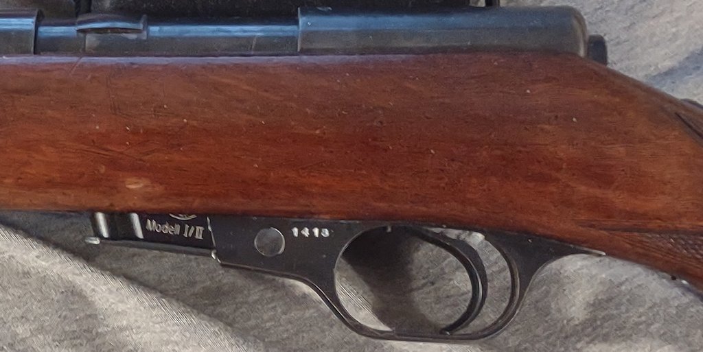

Easy tell for model -
Model 1 has a slimmer barrel, and a shotgun-style safety. No provision for upgraded rear sights.
Model 2 has a heavier profile barrel, Mauser-style flag safety and two holes drilled and tapped in the tang - where the older shotgun-style safety is located - to take proprietary peep sight - a VERY rare item that I've never seen. However, pal Raul Braudo in BA has one.
