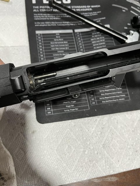

Okay I'm gonna sound really dumb. I know plenty about my pistols. But I have a fixed mag commie state AR-15 that has been nothing but trouble jamming and I haven't shot it much. I did find it needs to be very lubed to run okay.
But last week I had a somewhat catastrophic jam/double feed. One round was so jammed up at the top of the bolt that the damn charging handle and bolt would not move back. Long story short, the round actually was pulled apart getting it out. Luckily nothing was hitting the primer and the operation was somewhat a success. But now I gotta clean powder out of the damn thing and I noticed some damage inside, right near the dust cover.
Pic is below. Will this ding interfere with the bolt and cause more issues?
Also noticed that I can't just drop a round into the chamber (just testing to see if there is some issue causing my jams). I found that the round won't just drop in and would need to be pushed in with a fair amount of pressure (it drops about 3/4 way in before needing a push). Is that normal? I cleaned the bore with Hoppes and a bore snake. No change. My charging handle is fucked so I need to buy an new one.

The ding in the ejection port won't affect the function.
However, it does sound like you have chamber issues. Maybe clean it or get another barrel.

Do you have a borescope to look in the chamber? It could be some junk you can clean out rather than damage. Properly sized rounds should drop in with little to no pressure.
I also agree that the ding won’t affect anything and is cosmetic.
