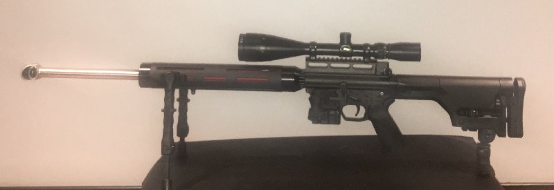

I had to look around and finally found my monopod, I'd put it in my M11/nine Lage uooer as a forward grip because it would fold up and out of the way ... not sure when I bought a set of bipod legs that attach to picitinny rails on the float tube but the only rails I had were long and didn't match so hopefully I can pouch up a pair the LGS tomorrow ... not sure when I'm going to get to the range again, I got my crankshaft back for the baja engine and wifey wants the guestroom painted before I go back to work on Saturday... but when I do get a chance, I'll be ready!

I figured out why these legs aren’t on anything ... they’re wobbly! I think I’ll try them out anyway.
