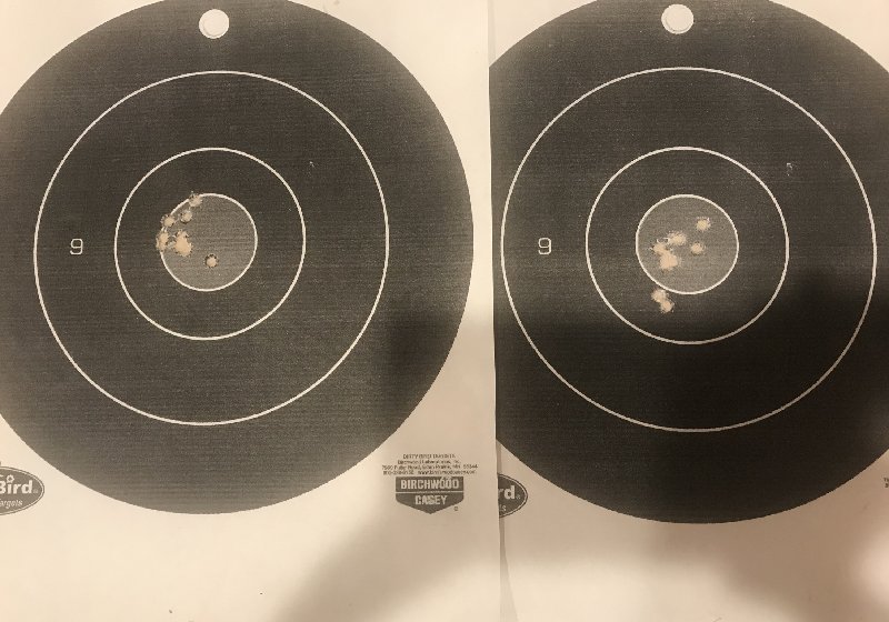

Finally ended up with 92 finished rounds that I confirmed by visual inspection and finish weight.
When I got out to the range, I was amazed, it was empty and the rest of the day went great ... it was the first time I'd shot this 20 something year old JP Enterprise upper and since I changed the lower receiver from a Bushmaster receiver with a hand-honed service rifle FCG and Wilson trigger I made into a trigger-shoe. to a Sharps "Jack", a real 2-stage trigger and Magpul PRS stock & grip, so it would "kinda" match my JP Enterprise 6.5 Creedmoor Sharps "Jack".

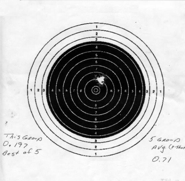

For the best part of the last 20 years it looked like this, and this is the best of 5 targets) 3-shot group from back then.
Now with the Jack receiver the upper to lower fit is a bit sloppy, but in all fairness in the Bushmaster receiver had a JP Enterprise Tension pin that pulls the upper and lower together and makes them a rock solid unit ... I'm going to move it over and see if I can't tighten up the groups next week ... they aren't "bad" but they used to be much tighter; or maybe the barrel is just worn out Frown
Granted these are 10 shot groups, and in both I pulled a couple, but I was hoping for better ... maybe I could blame it on my glasses(which I didnt need back then)

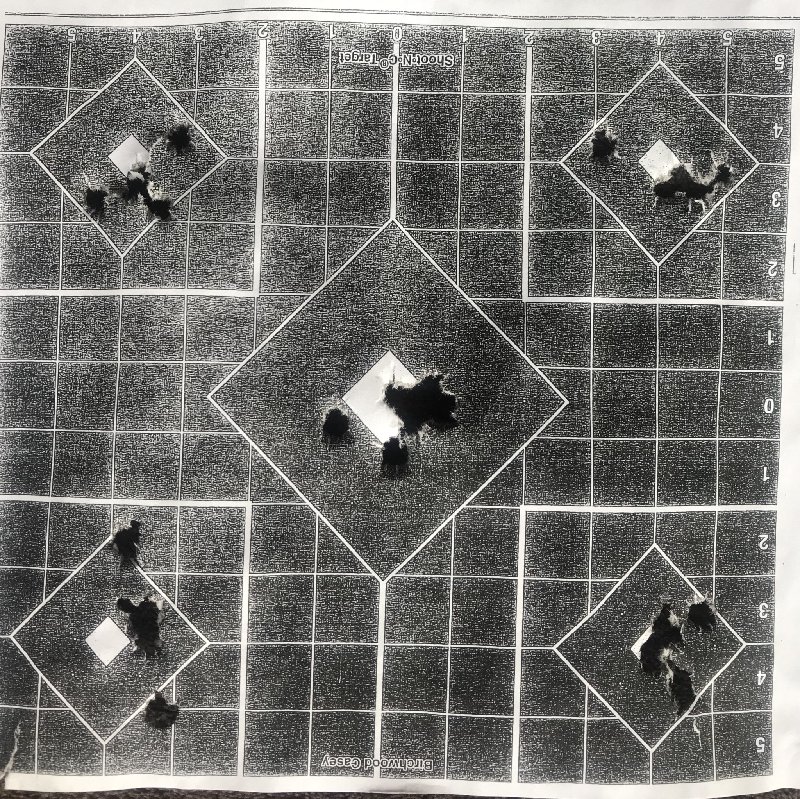

I got up early before the rain started to shoot the JP upper again to see if the Tension Pin made any difference and my group’s tightened up considerably. Different targets, the center is a 1/2” square(diamond), and the ones in the corners are 1/4”
Both targets are 10 in the center and 5 in the corners
First target, all rounds are single load
Second target, all rounds are mag fed.
Good shooting, I see mostly vertical in your groups. How did you shoot? Bench, prone, rear bag...?

Picture of kimberkid
I was at the bench, off a bipod

I agree with offgrid that vertical variation seems to be your primary accuracy issue. A few thoughts....
7k to 10k rounds on a 223 barrel is more than enough to decrease accuracy. A shot out barrel usually shows itself at longer distances first. My shot out AR-15 barrels were still pretty accurate at 100 yards, but I pulled them when accuracy went south at 300-400 yards. Vertical stringing was the primary accuracy problem. With my stainless steel barrels, accuracy went from good to crap within 100-200 rounds.
I vaguely recall you shoot SMK 69 loads in your AR-15 when shooting for accuracy. Factory ammo with SMK 69 bullets are universally the most accurate loads across my multiple barrels. If SMK 69 ammo won't shoot in a rifle with an adequate twist rate, the barrel is likely toast.
I suspect you're using some form of rear bag with your bipod on the bench. Vertical stringing can occur from both the front and the rear of the rifle. A Harris bipod is prone to hopping, especially from a hard, smooth surface and when the bipod isn't loaded properly. This could be a source of some vertical stringing.
Vertical stringing has been an ongoing issue for me, generally by throwing rounds higher than POA. My high rounds were a combination of:
- Excess downward cheek weld pressure on the buttstock. Mainly a technique flaw, this was made worse by some scopes being mounted too low.
- Relaxing my hand grip on the rear bag right as I was breaking the shot.
These two dropped the rear of the gun, sending the shot high. I pretty much figured this out during a 2-day precision rifle match, while talking through some of my sheep-dip stages with a buddy I was shooting with.
Although it's possible that large muzzle velocity variations among rounds could cause your vertical stringing, I doubt your ammo has that much MV variation.
