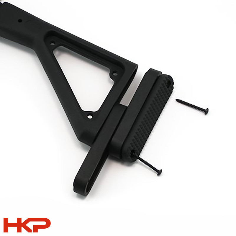

This one might work, with a listed LOP of 18"
https://www.robertrtg.com/stor...P5-HK94-134p6789.htm
