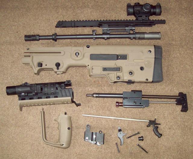

Well, the thermometer on the deck is reading 22 degrees and since I’m not quite ready for sub-freezing range time yet, I thought I would take you along while fixing some pup issues…
After shooting these side by side, in was obvious that the FDE rifle needed a few upgrades.

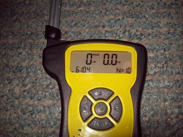

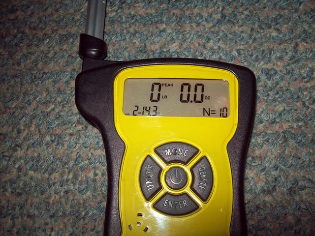

1. Trigger – FDE trigger pull, while not bad at all for a bullpup, was severely lacking next to the Geissele. A long, somewhat mushy take-up (similar to a striker fired pistol trigger) that breaks at about 6 lb10 oz with some additional room to the wall after reset. While a trigger pull weight of 6.5+ lbs. is not an issue, the spongy pull and break is.
2. Cutlass style grip makes it way too easy for middle finger to slide behind trigger.
3. Shortness of forend makes for a weird wrist angle on support hand.
To be continued...UPS on the way with some parts

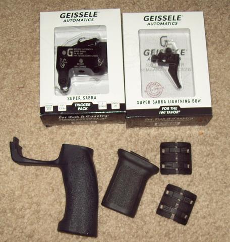

My blowed-up rifle patiently awaiting UPS...
____________
Pace
Posts: 1683 | Location: in the PA woods | Registered: March 11, 2013Reply With QuoteReport This Post
Ok then...Parts is parts.
Be back when she's back together.

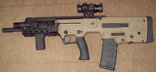

And... she's done!
1.Add Geissele Super Sabra trigger pack and Lightning Bow.Mushy take-up gone with a crisp trigger break sitting @ just under 3 lbs. Reset is to wall with no take-up. Perfect!
2. Add 3PP pistol grip
3. Add BCM vertical grip
4. Add some Magpul XTM rail covers
Problems solved Big Grin
