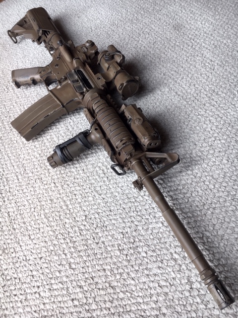

I rattled canned a beater a few years ago. I used mil spec spray paint. It turned out fine. I hung it in my garage on a coat hanger and went to town with 4 different shades of brown.
Wipe it with alcohol really good to clean any grease or oils before you paint it.
Have fun. There won’t be another like it.

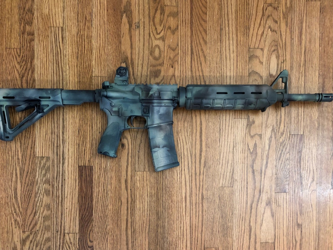

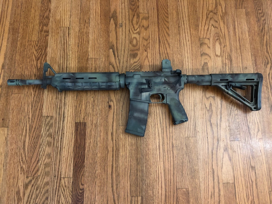

Took a crack at it today. I’m pretty pleased with it. Degreased it with brake cleaner. Put down a base coat of dark forest green then used some twigs with leaves as a stencil for khaki, earth brown and army green.
Wish I could post pictures.
Thanks for the tips.

Here are Ruger357's pics of his rattle canned rifle. i will post them for him. Looks great Ruger!!!

The biggest thing to decide is if you are doing it for coolie/style points or for effectiveness.
Nearly any self camo scheme with nature representative colors will be more effective than a black weapon in nature, regardless if it 'well done' or 'cool looking'.
Obviously it can be both, but a black rifle sticks out in nature like a neon sign.
Whether than matters to you or not is a personal issue. I have 2 rifles painted in a Multicam Tropic scheme and am doing a 3rd with all my free time. I really don't prep at all, other than taping sights, optics, and some markings.
That rifle look great. Nice combo of earth tones and natural patterns.
Now just don't set it down in the woods. Big Grin

GW, thanks for posting the pics for me. I’m pretty happy for a first timer with no artistic ability.
Thanks for the tips and compliments. The other ones on here look great too. I enjoyed doing it and it helped pass the time. I’ve kinda got the big to do another one. Maybe a shotgun or pistol.
