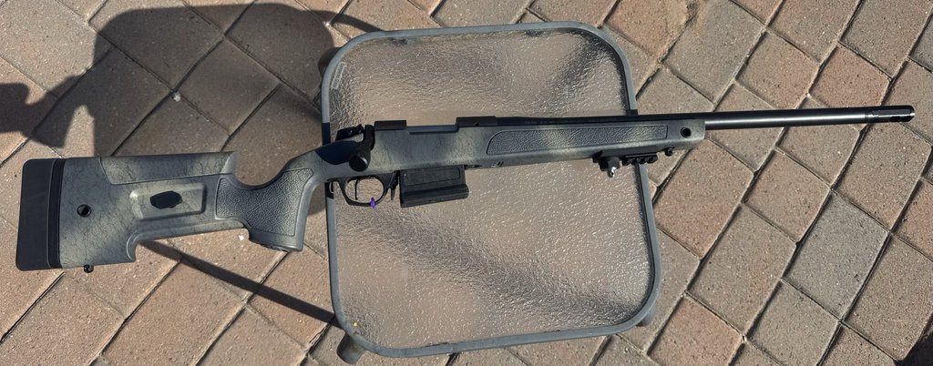

Traded in to a Bergara B-14. I guess I'm doing the PRS thing. Login/Join
Maybe 72 hours ago, I'd never even looked at the brand, didn't know anything about it other than having heard or seen the name in passing. I was wandering around my local shop and saw one on the wall, and was intrigued. Later in the day, one of the guys in my shooting group posted a video of the trigger pull in his after installing a TriggerTech, and some discussion followed. Then I realized I had shot another friend's Gucci'd out 6.5 Creedmoor in an MDT chassis about a month ago. He let me put three of his handloads through it on some 6" plates at 650 yards. It felt like cheating, it was far easier than it seemed like it ought to be. He told me he had $6k in his PRS setup, and that was considered a "budget build." Lots of sixes in that paragraph.
Without going into the details of it, I did really well on an even trade for a pistol I've never shot that was just taking up room in the safe, and came home with this Bergara B-14 in .308. The barrel is engraved "BPF" and it's in an HMR stock. Whatever all that means. I actually had a choice between this one, and one in 6.5 Creedmoor for the same price that was actually in basically brand new condition that I was really tempted by. Honestly, it probably would've been the better performer of the two, but between having at least three thousand rounds of .308 I inherited, plus a bunch of brass, plus a reloading setup, I figured at least I could get my feet wet with the PRS matches some of the guys have been trying to get people to join. Oh, and this one has a TriggerTech trigger in it, which the 6.5 did not. I also recall the punchline of my reading on the .308 vs 6.5 discussion here being that yes, 6.5 is objectively better, but .308 is probably more than adequate for 95% of my purposes.
It has some Surefire monstrosity of a brake on it that isn't even timed, so I figure it was probably just used as a thread protector. I'm going to order a Plan B brake of some sort and throw my .30 cal Stealth Additive Ekron on it. I'm leaning towards a radial so I don't have to screw with timing it. Probably will not shoot it much unsuppressed. These days, I just hate the concussion and blast, I'm totally spoiled now.
I ordered a Weaver 20 moa rail and some Vortex medium height rings, and I have a L.O.W. made Weaver 3-10 I can throw on it until I have the budget for some "real" glass, so I'll at least get to have some fun with it soon. I have a friend who is already trying to sell me an Athlon Ares Gen II 2.5-15X or Cronus Gen II 4.5-29X. He's shooting a PRS match this Sunday, and I'm going to spectate and check out those Athlons, kinda get a feel for the whole thing. Until the last year or so, I'd honestly never knowingly shot past 100 yards. I'm regularly shooting steel out to 300 at the public range for my home club, and a few rifle matches will give me access to the range that has steels set up at almost a thousand yards. Really excited to get into the long range thing.

Beautiful rifle Smudge. What is the weight on that one?
Thanks! My bathroom scale puts it at 9.7lbs unloaded as pictured. With rail, rings, scope, bipod, suppressor and wrap (I don't bother with them except with magnified optics because suppressor mirage is definitely real), probably somewhere in the 12lb range, maybe more. Hard to say. I wouldn't hunt with this one lol. Definitely a PRS rifle. My friend's 6.5 shocked me at how heavy it was, but you know what? Incredibly stable setup. Using a rear bag and squeezing it to walk my crosshairs onto the target was a novel experience. Wink

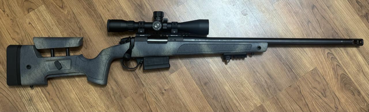

Well, my friend wants to charge me new prices for used Chinese scopes, so I ordered the correct rings for the Weaver Grand Slam and I'll just start off with the Japanese scope I already own. It's this one. I figure I could do a lot worse.
The rings should be here tomorrow, but I won't be able to make it to the range for a bit.

Don't buy Chinese optics. Just don't.
The Weaver Grand Slam will get you started. You'll want something better once you get behind other people's rifles. The Grand Slam's weaknesses include:
- 10x is on the lower end for a PRS scope, but it can work. IMO most targets can be handled with around 12x to 15x. Much more magnification and it can be difficult to jump to different targets. Much less and it can be difficult to hold wind or elevation accurately. 20x to 25x is useful for longer distance targets, from stable positions, when stage time limits are generous.
- Second focal plane means that your reticle is only accurate at 10x. Of course you'll probably shooting all the time at 10x, so it might work OK.
- It lacks a zero stop. You'll find about the benefits of a zero stop when you start dialing elevations a lot.
- I don't think it has parallax adjustment. Over time, you'll find the benefits of a parallax turret.
- A mil dot reticle's graduations are pretty course for accurate holds for wind and elevation.
- The reticle appears to have limited hold over graduations, before it goes into a solid black line. This means you will likely be dialing elevations more than you will be holding elevations.
Posts: 8539 | Location: Colorado | Registered: January 26, 2008Reply With QuoteReport This Post
Correct, no parallax adjustment. I'll have to be really conscious of a consistent cheek weld.
Oof, those combined sound like a recipe for headaches. I'll make it work for now and just start budgeting for something decent.
