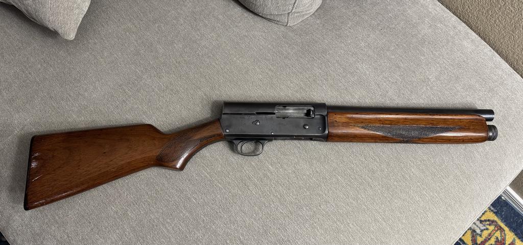

I've mentioned it here and there, but when the news came out about the $0 tax, this was one of the first things that came to mind. Picked this candidate up at a shop for $150 last fall, complete with some surface rust, some cracks in the stock and fore end, and a bad ding in the barrel about four inches from the muzzle. Perfect!

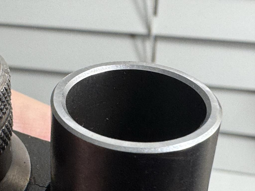

Stamp took 44 days. Just picked up the receiver from being engraved. My machinist friend chopped the barrel for me and chamfered the muzzle in his Bridgeport. He chuckled about the barrel being both out of round, and varying wall thickness. I pointed out that in 1921, the Ilion plant was using steam engines and leather belts driving their machinery. He paused, considering, and offered "then it looks pretty goddamned good, considering."

That is absolutely cool! I'd love to know how it shoots.

So would I, but for a different reason. Did it function before? I know it wouldn't have been a good idea to shoot it in its "before" state with a dented barrel or cracked stock, but I wouldn't want to do all that work and then have it be a single-shot.
Posts: 32299 | Location: Johnson City, TN | Registered: April 28, 2012Reply With QuoteReport This Post
Oh, it works great. I put a box of low brass through it a couple of months ago and it ran without a hiccup. The stock isn’t cracked in a way that it would come apart catastrophically if it let loose and the barrel ding looks very old and I was pretty confident it had been shot that way, so I went for it. I figure I’ve done riskier things. Big Grin
Anyways, I am frankly more concerned about the cracks in the fore end from a functional standpoint. The gun relies on the integrity of the handguard to keep cycling correctly, and when I got it, it was missing the friction collar, so it had been shot with the braking system disabled for who knows how long and how many rounds. I sourced one and installed it set up for heavy loads and it cycled those 8 1/2’s just fine. The hammer spring feels pretty anemic, so between those two things, I’m thinking the gun would benefit from being fully resprung.

I’ll respond to some comments in a bit more depth later, but for now, I’ll say it absolutely functions just fine. I took it to an NFA night shoot afterparty kind of thing last night. Three folding tables covered with machine guns, SBR’s and suppressors and this was the gun that garnered the most excitement besides the MP5. Cycles great with 8’s and with 00 buck and slugs. Interestingly to me, it didn’t see to recoil any differently depending on what you fired through it. Zero malfunctions. Recoil was… stout. I thought for sure I’d be bruised today, but I’m not. I’m looking forward to the restoration!
