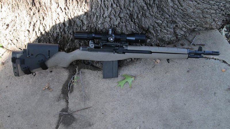

If you want to reduce the overall length, you could remove that long combination front sight/muzzle device, and install a Smith Enterprises gas lock front sight instead.
This is available either with an integral hooded front sight: https://www.smithenterprise.co...-front-sight-hooded/
Or a gas lock with a dovetail for a standard USGI front sight: https://www.smithenterprise.co...-glfs-d-22-dovetail/
You could then cap the muzzle threads with either a short muzzle brake or just a thread protector. With no muzzle device, this brings the length back to just the 19.25" barrel, about 4 inches shorter than the current configuration with its long combo front sight/muzzle device.
I did that with my 18" M1A Scout, which comes with the standard combo front sight/muzzle device in its original configuration. I swapped it for a SEI hooded gas lock front sight and a shorter flash hider, bringing it down to not much longer in OAL than a 16" M1A SOCOM with its chunky front sight and muzzle brake:

I did that with my 18" M1A Scout "pic"
Look, if you keep posting this picture I'm going to have to file for a restraining order. It's cruel and definately harassing my wallet.
See, here I was considering taking and posting a newer photo of it in its current configuration.
That one's like 3 years old, and doesn't reflect the additional upgrades I've made since...
