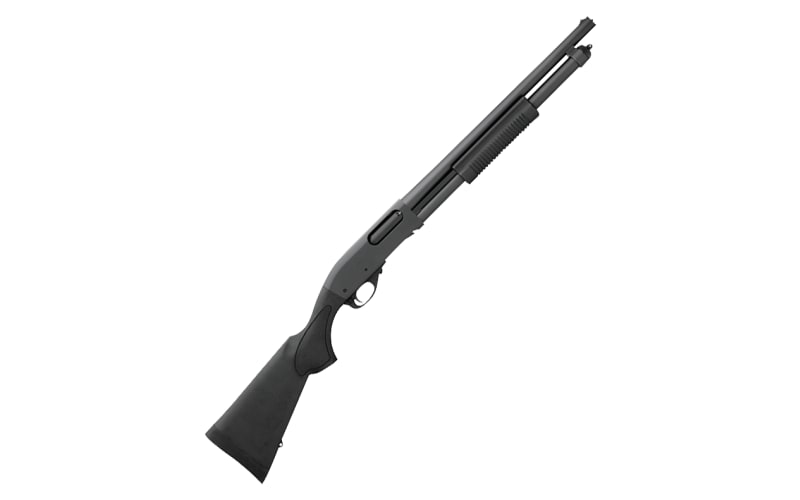

That's mostly correct. But there are factory 870s without separate magazine extensions that do hold more than 4 shells, the "Tactical" line, which are distinguishable by the longer magazine tube protruding ahead of the pump and the guide ring on the 18.5" barrel being located just behind the front sight instead of ~1/3 of the way down the barrel at the end of the pump:
