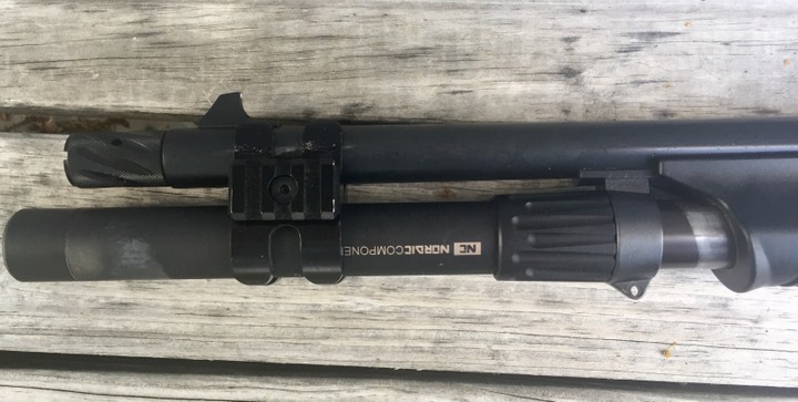

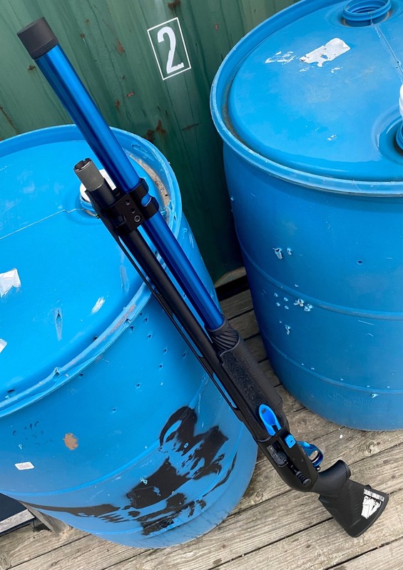

^^^ A realistic defensive situation for me, if it were to happen at all, would be more like 15 feet. (the approximate distance from the kitchen counter to the front door) I ordered an extended mag tube, spring & follower kit to increase the round count to 7. This is the second time; I ordered an 8-round first, but it protrudes one shell-length beyond the muzzle. | |||
| His diet consists of black coffee, and sarcasm. ![]() |
Got the mag extension kit installed today. With the supplied follower I just could not get the seventh shell to go in, and also had some cycling problems. The instructions did say the original could be used. Comparing them, the new follower looked to be about 3/8" thicker, which would make the spring/follower stack longer ... about the distance lacking to load the last shell. I disassembled them, put it back together with the original follower, and then was able to load the seventh shell, but it still took some effort. No cycling problems this time. | |||
