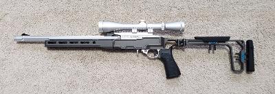

Picture of Tuckerrnr1
Ruger 10/22 take-down receiver and bolt
Tactical solutions barrel
Pike trigger housing, bolt handle, rings, and scope base
Tandemkross trigger assembly
Leupold VX-2 3-9x40
Grey Birch La Chassis TKD
Grey Birch recently moved to Florida from Canada to produce their products here in America. The quality is second to none and the customer service I can't say enough about.

A few questionS- why did you choose to put the scope on the receiver vs the barrel?
How do you like the trigger?
I’m asking because soon, a Take-down 10/22 is my next project.

That is sweet. Made me go on their website buy I couldn’t find the takedown version. That is a nice little build. Good job.
How do those takedown models shoot (accuracy) when the sight isn’t mounted on the barrel?

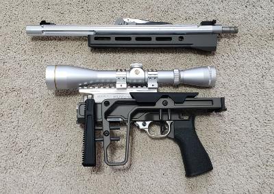

Haven't got this setup to the range but when it was in a Hogue stock, it grouped sub MOA out to at least 50 yards. The Tactical Solutions barrel does not have provisions for mounting an optic. Also the Grey Birch chassis has a second point of contact screw at the rear of the receiver and the take down components are removed from the barrel and housed in the handguard section.

I ask because I don't know:
What's your zero after re-mounting the barrel?
Is there that much of a shift in zero?
My thought process is mounting the scope on a cantilever off the barrel, because that would be "truer" to the accuracy of the round.
I could be wrong...
I know that every other gun that isn't a take down, mounting it to the receiver is the norm. But this being a take down, things might be different.
Yes, I know it's a Ruger 10/22 and not a custom built sniper set up, but I want to squeeze as much accuracy as I can out of it, and not worry too much about a change in POA/POI when I take the barrel on and off. Or I just might be asking a question to a non-existing problem.
