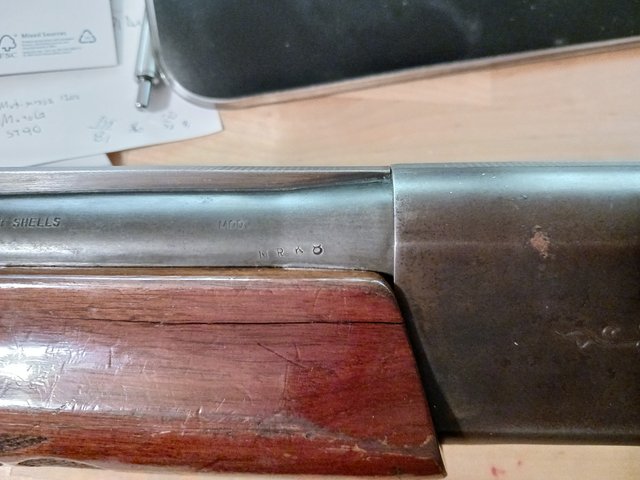

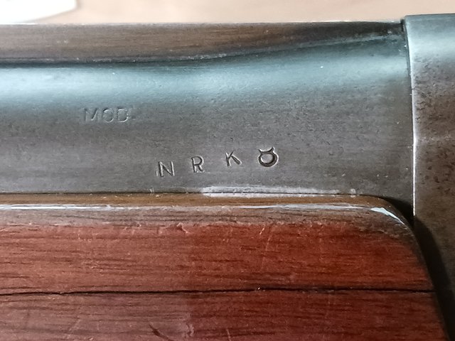

Haha, my curiosity wouldn't let me wait 'til morning.
I see four characters stamped into the barrel, on the left side, just ahead of the receiver: looks like NRK8. And that doesn't make sense if the date codes are two-character.
If I take the R and the K from the middle, then I can make November 1963 out of it. The next K is 1990, and this gun is way older than that.

Yes, RK for November 1963. First year of production, which explains the unexpected metal barrel seal.
Before the date code is an inspection stamp, and after is an assembly code.
Yours was never sent for factory repair, so doesn't have the first four repair markings shown below, just the latter four. Inspection marks varied.

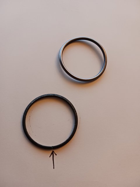

Pics of the old and new O-rings, new looks silver, old is dark:

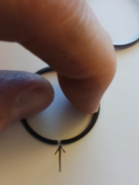

I have to force it just a little, but here's the split in the original ring:
Following YellowJacket's post, I'm wondering now if I should put that original o-ring back in place... it seems the ejector is the more likely root of the problem.
