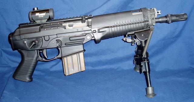

I can't say enough good about my P556. It's a little piggy is the only knock. It loves 62 grain most everything. I don't shoot 100 yard groups with it but 50 yard red dot groups produce clovers. Even with green tip, silver bear 62 grain, etc. It's baffling. Hates 55 grain and 75-77 aren't impressive either. I like the hybrid nature of the swiss design and AR stock and mags. I did however shoot the rail loose and had to secure it down, but no problems since.
Here's when I first got it, one of the first ones to arrive in stores. Here fishy fishy.
Setup now.

Less the stock, that's exactly how mine looked when I got it in December 2008, I got it as a Christmas present to myself ... it may be worth noting, I applied for my stamp to SBR it on Jan 9,2009, approved on April 8, 2009 ... 3 months and this was when we were still mailing them in!
BTW, mine likes 62 grain best too ...
I made my own handguard end-cap and cut down a set of 551's. I never took a single picture with the fishy-guards on it, but theyre still in a box somewhere!

I remember yours shooting good with 62 grain Silver Bear years back and it verified what I was seeing cause I couldn't believe it in mine.
I got a buddy who would probably pay to get you to make him that handguard cap. I had to look back and remember where I got mine, and they don't have anymore. So I sent him my fishy setup for his backup.
If they had braces back then I'd probably have 2 of these pistols. And I love the swiss stock, but for the pistol I like having the option of different lengths vs the folder). Generally I take the folder every time but this rifle is short enough already for me.
