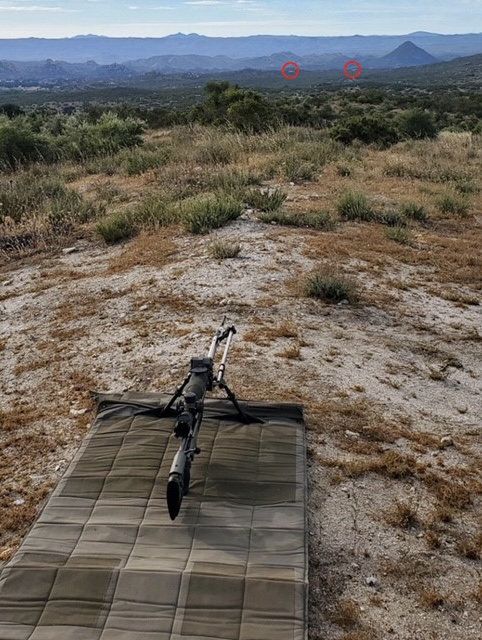

Although I've been shooting on a regular basis between 1860 yards and 2600 yards for the last couple of years (and out to 3643 on a ULR road trip), we were finally able to get out and clear a couple of target areas beyond 3000 yards where we shoot 2.5 hours from home. The picture below shows one area (left circle) that is 3231 yards (1.835 miles) and the other (right circle) is 3580 yards (2.03 miles). We only had time to set up 1 target at the 3231 yardage which is the 40"x40" white square (1.23 MOA) shown in a picture looking through the spotter. Shooting was a little difficult as the winds were gusting between 10 - 20 mph over terrain that wrecks havoc with air flow but we got impact on the 9th shot. Had several just off the edges but the wind had other ideas. Plans are to set permanent targets out at these 3000+ target areas and use portable targets at 1650, 1860 and 2400 yards for shooters with less "gun".
Rifle is a 33XC shooting Berger 300 Hybrids in an Accuracy AXMC under a Vortex Razor 4.5-27x56 with a Charlie Tarac.
Edited to add: for the guys who like numbers, the 40" square plate at 3231 yards with my rifle has a maximum of 10 fps vertical and a 0.7 mph wind horizontal. This target gives us 20" of plate up and 20" down from center (elevation) as well as 20" of plate left and 20" right from center (windage). What this means is the muzzle velocity HAS to be within 5 fps +/- of the average AND the wind call HAS to be within +/- 0.35 mph to hit the target
