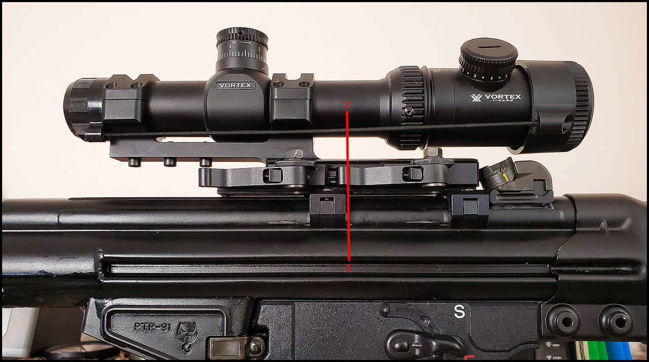

What is your sight height over bore measurement? Measure this as best as possible -- from center of rifle bore to center of scope. | |||
| Member |
Fritz, it looks to be about 3.5"
| Member |
OK, using a boatload of assumptions here: - muzzle velocity of 2,650 fps. The lower MV is in line with test done by rifleshooter.com - air density altitude of 2,000 feet above sea level. This probably covers current air conditions for you on the coast. guestimates per JBM .8" high at 50 yards 3.8" high at 100 5.3" high at 150 3.6" high at 250 zero at 300 yards 5.6" low at 350 yards 13.3" low at 400 yards | |||
