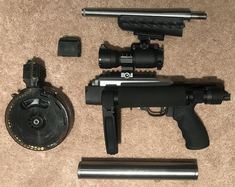

I fumble with the 10 round 10/22 magazines and find them frustrating which is likely why I am
not really fond of the gun. Plus I really like my Marlin and Remington tube feds guns. But the 15 rounders working kind of like an AK in the pistol grip gun is much smoother so I may dig this setup in the end.
Anywho I came across a 10/22 Charger for stupid cheap. Figured I would toss a red dot and a bipod on it for the kids so I bought it and threw a brace on just because.
Neat enough. But then I wanted a super compact folding backpack gun and came across a 6” Kidd barrel it that did not fit the Ruger Chassis so that led me to a PMACA Chassis and A3 Tactical 1913 adapter. So I tossed everything together. Turns out the PMACA chassis requires an AR pistol grip with no beaver tail and I have exactly ZERO of those.
So the disassembly and reassembly leads me to some questions.
When I remove the receiver from the chassis the large rear bolt pin (I believe) literally just falls out of either side. There is no resistance at all. Is this a problem?
Next, the bolt it pretty rough what is the best way to clean this up?
I used some M PRO7 CLP but it did not really do much.
Then when I installed the barrel there is a touch of a gap between the barrel and the receiver. The extractor falls in the slot on the barrel just fine and the bolt meets the back of the barrel face with no gap.
Is there good drop in trigger group that does not break the bank?

Bolt stop pin: normal for it to fall out. Recommend replacing it with one of the various synthetic options.
Bolt: steel wool, oil and elbow grease. Or have a shop vapor blast it.
Trigger: best bang for the buck is a Volquartsen hammer. Add a pencil eraser to the back of the trigger to limit overtravel. (I used Acraglass on one and the eraser stayed put for ten years).

For the trigger: The Volquartsen Hammer kit is an amazing upgrade for under $40. Also get the auto bolt release, and an extended mag release. You will be taking the trigger apart, those upgrades help.

Super easy. There are a couple of YouTube videos showing how to do it. IIRC it was about 15-20 minutes of work. Probably would have gone faster but I was following along with the video and was rewinding a few times to make sure I got it right. And you have to remove the bolt hold open part to replace the hammer. Get the Auto bolt release part with the hammer. It is so much easier to release the bolt by grabbing the charging handle and give a tug back than trying to manipulate the bolt release in front of the trigger.
OK, just checked Amazon, and looks like they no longer have Volquatrsen products. But here are the two I recommend:
https://volquartsen.com/inventory_configurations/817
https://volquartsen.com/produc...tomatic-bolt-release
Maybe Midway or Brownell's has them for a little less.
Last item is Kidd makes a nice mag release that conforms to the trigger guard.

Since you bought this Charger super cheap for the kids, but then it morphed into a super short, suppressed backpack gun with a Kidd barrel, PCMACA Chassis, mag release light trigger and what looks like a Steiner red dot, with a BT suppressor “incoming” (I like your build by the way)
