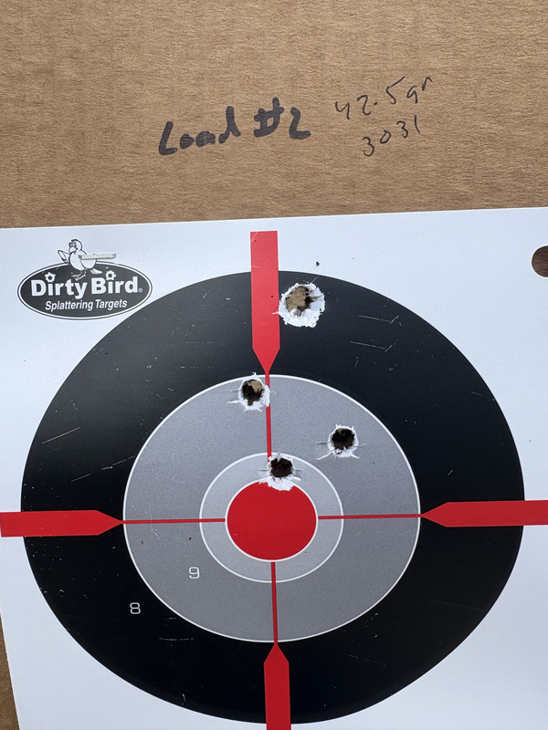

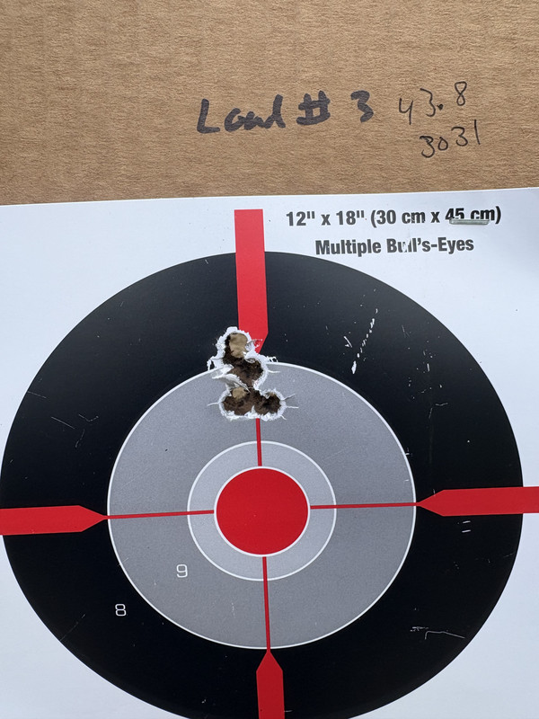

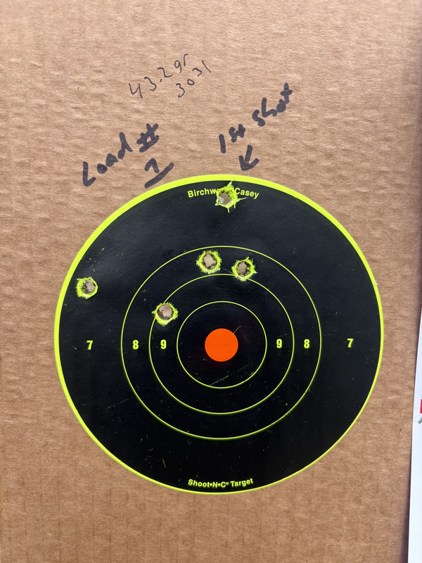

Hello guys,
Here is a short update for load development for this gun. I tried 3 different loads of IMR 3031 at 50yds with my red dot. The 3rd and final load was outstanding and will probably be my load for pigs if I am able to duplicate the accuracy achieved today. The speed and SD’s where fantastic as well from the 16” barrel.
Load #1 43.2gr 3031 at 2.70 OAL
SD 10.9
Avg velocity 2654
(Gave the largest group)
Load #2 43.5gr 3031 at 2.70 OAL
SD 8.7
Avg Velocity 2700
(Group started to shrink with this load)
Load #3 43.8gr 3031 at 2.70 OAL
SD 12.8
Avg velocity 2722
This load gave me all 5 shots touching at 50yds with low recoil. I could shoot this all day. I hope it does well at 100.
